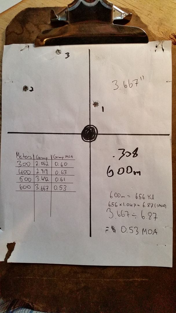

I have a 1981 vintage heavy barrel BDL in .308, glass bedded both action and bottom metal and floated. 20x Leupold M8 with a target dot (from the 70s). How much would this package be on the EE? $800-$900 maybe? With handloads it is absolutely consistently .6 MOA. Here is a 600 meter group, no it is not cherry picked, in fact these three shots are the only ones I've fired from this rifle at this range.
Precision does not have to be expensive. I would start with a quality foundation though which the Axis is not IMO.
