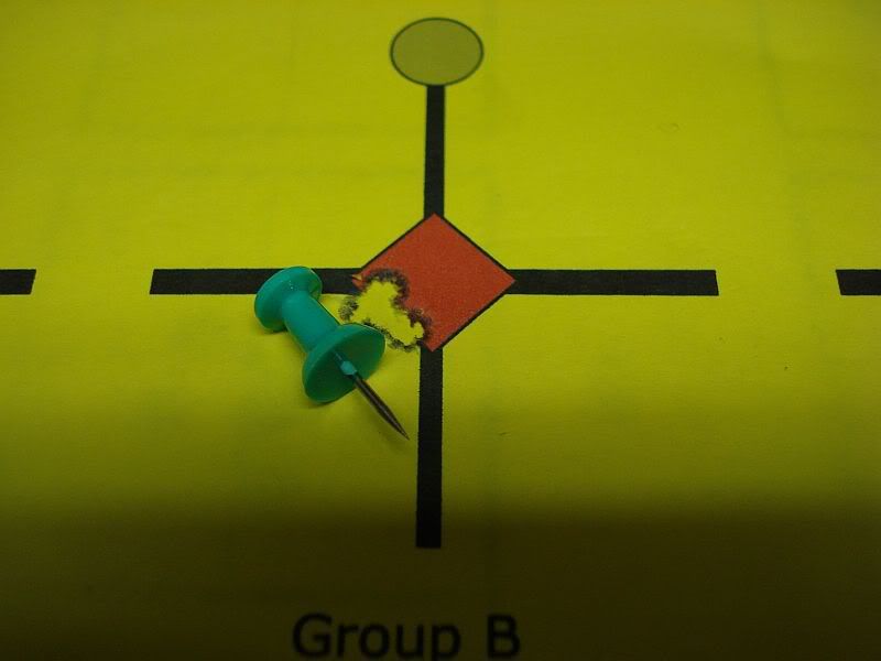

This pic the result of 5 shots from a new barrell "almost" clean.
over 100 shots under 150 through it.
