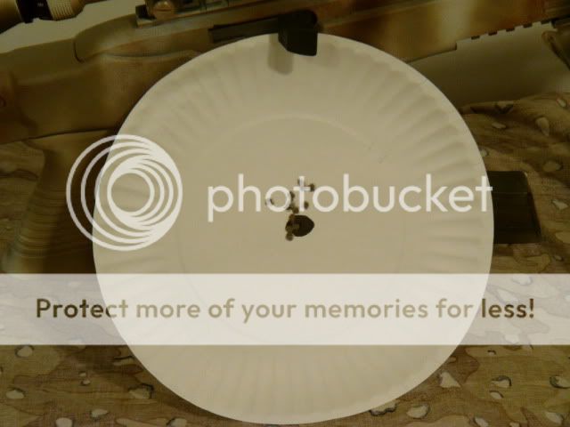

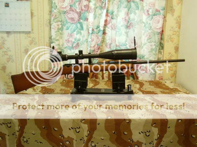

Not to much of a story behind the gun. Marlin 925M....10-40x50 scope....I wanted an inexensive gun for paper punching or maybe a ground hog or two. I had a terriable time trying to get the scope sighted in. No matter what I tried it shot all over the place. I changed mounts, rings.....swapped everything front to rear and back...I even tried shimming the scope to try and force it into place...Nothing worked....As a final attemt, I pulled the gun apart and put some arts and crafts rubber sheet under the action and raised the barrel just enough to get a dollar bill under it all the way to the first bolt.
Now it is a tack driver....it will do pennies all day long at 100 yards.

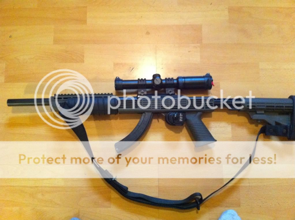

My Grand Daughters favorite gun:
Standard ruger 10/22 with Tapco T-6, a cheap scope, and bipod...Not bad shooting for an 11 years old....She really loves that gun.

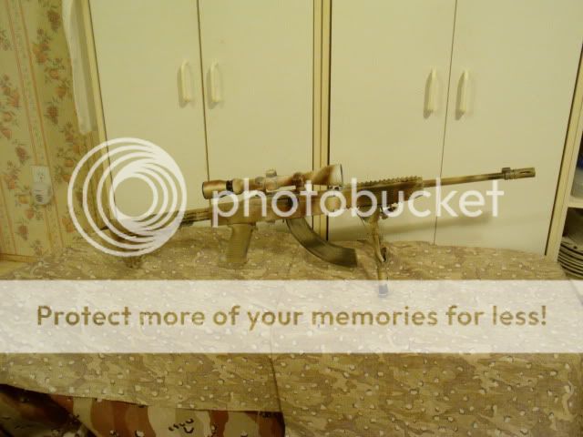

I was thinking about turning my MKII FV into that, but I am too far away from my guns to do anything with them. Btw, those are some pretty tacticool socks.
