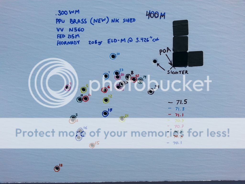

So, here are the first impressions with PPU .300WM brass
- Factory annealed for the win! Unless you like the look of brass where the annealing discolouration is tumbled / cleaned off....you do you as the cool kids say these days.
- It's bagged and thus the odd case mouth might get dented. I ran my brass through a Redding Neck Sizer with imperial graphite / application media for lube. Neck tension felt normal.
- The flash holes looked to be punched; there are visually obvious burrs inside the case where the flash holes are. I've never bothered to deburr / haven't tested the idea yet but FYI for the camps that do.
- Primer pockets felt tight but not even / parallel if that makes sense; almost as if one is seating primers without removing a slight pocket crimp or the bottom of the pockets are wider than at the top. Primer pocket depth seems consistent; I tried to run a Redding uniforming tool inside the first few and the cutter barely even made contact with the pocket. I had no issues priming though; I use Federal 215M primers for .300wm and an RCBS Bench Priming Tool (not the APS strip model) to prime rifle cases off the press.
- Case lengths are within 0.003" of eachother; average length is approx 2.606" putting the brass about 0.004" below trim length depending what your load data may say. I chamfered / deburred the cases and load tested with them as is for length.
The first batch I did a ladder test with all survived the first firing; decapping the fired cases at home indicated the primer pockets stayed tight (even at warmer charges.) The cool part is I found a potential accuracy node that lets me fireform brass yet still wreak awesomeness with accuracy (at least at 400m anyway...
