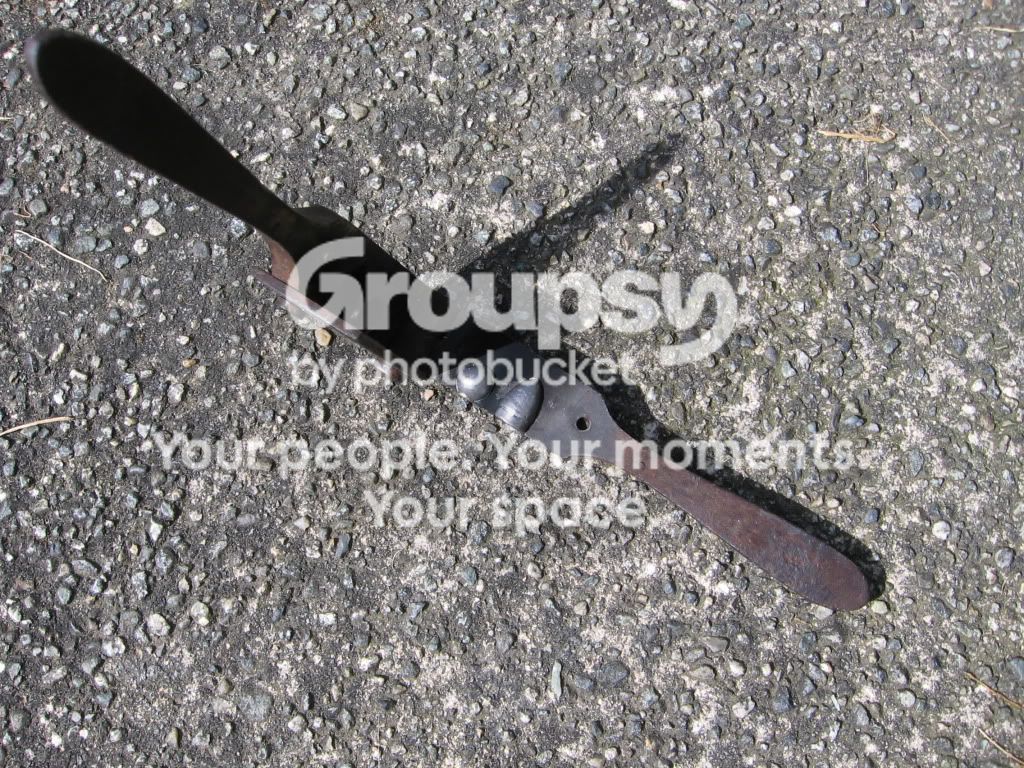

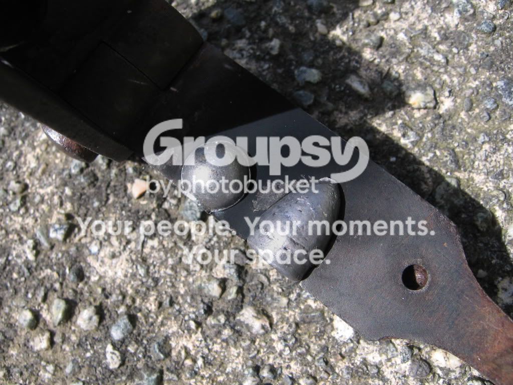

Here are a couple of pictures of a 150 year old .31 Colt mold which still makes usable balls and bullets.
Once you get into production you don't need to add more soot unless the balls start to stick.
