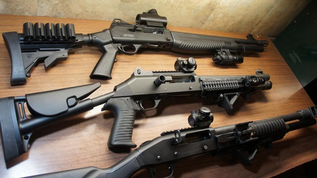

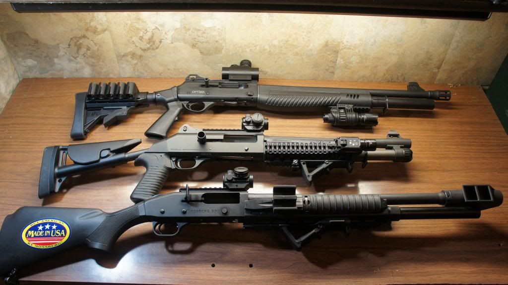

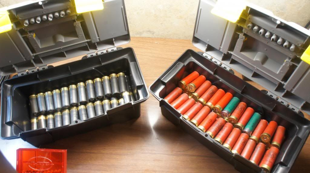

What you see are two three quarter inch 1 ounce 12g #6loads and 1ounce slug hand loads that are used on all 3 semi auto pictured below.
Shot and slug rounds have been chronyed @ only 1150fps using Red Dot powder CCI primers pink Winchester wads.
I can actually go even under 1100fps and the MP-A still cycles flawless.

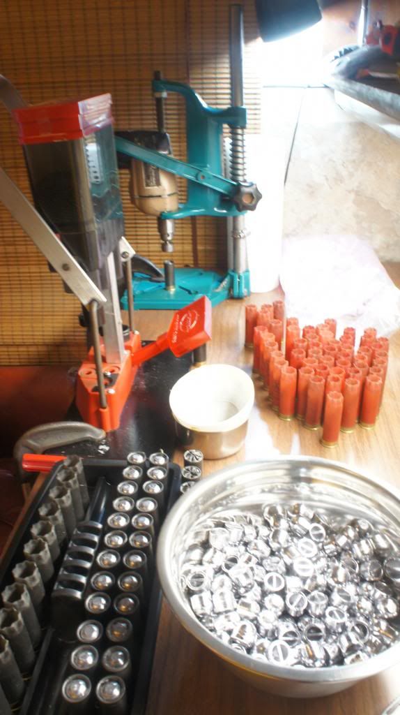

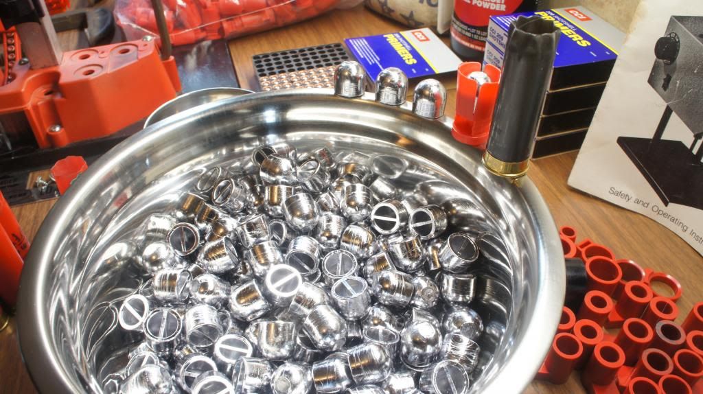

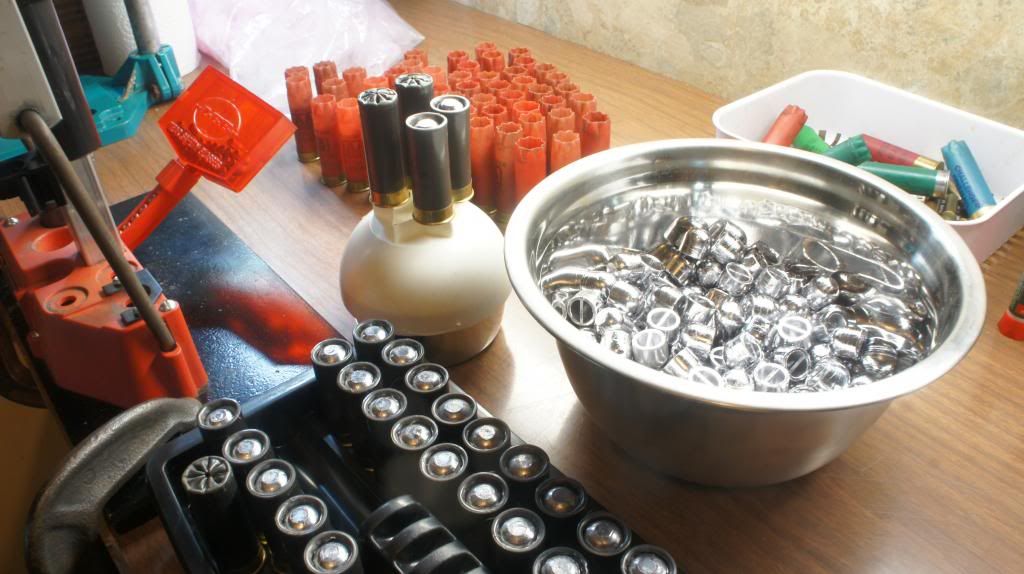

Lee Loader 2 along with a Lee mold 1ounce ( Im going to get the 7/8 ounce to save on the lead) a lead smelter and you can easily make what you see in these pics.
TOTAL Cost per 1ounce 12g slug - $0.26 VS. $1.00+ for commercial loads.
Have fun save $$$$ and be SAFE making this stuff !
