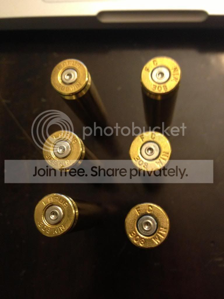

Looking for some input on the primers picture below, here is the background on what I am shooting/loading:
I'm concerned by what appears to be cratering on the primer on the reloads picture below but see similar primer marks on the factory ammo I have put through the rifle, the bolt cycles fine and is not sticky or heavy to lift on either the reloads or the factory ammo. The primers still have a curve to their edges that can be felt by fingernail drug across them and don't feel or appear to be flattened out at all from what I can see and feel. The rifle has always left a these crisp indent (and not the perfectly smooth little flowing indents I see on other rifle/ammo combos) on primers since I've owned it and is bone stock no modifications to bolt or action to date...maybe this is just the way these firing pins hit?
I realize one pressure sign isn't in and of itself an indication of a problem with a load but always like to bounce these sort of things out to this audience to be certain and get a healthy dose of second, third, 500th opinion ;-) . Thoughts and opinions welcomed.

Brass pictured on left is Lapua Reloads (described above) Brass on pictured on right is Federal 165 Grain Sierra Gameking BTSP (only factory stuff I had on hand to compare too)
Devlin;
My Rem 40X in .223 Rem used to do that until I had the firing pin hole in the bolt face bushed. Looking at the data you present above; your loads appear to be quite reasonable.
Brian
^^^^ exactly , my 5r does it to nothing to worry about really you could have the hole bushed if you want to . I've never bothered and run 45.4gn of varget under a 175smk

A young friend of mine bought a Remington 700 Police in 223 and the firing pin hole was huge. Firing factory ammo the primer flowed back into the hole and cratered on the firing pin. It was much worse than yours it was jagged and on the verge of rupturing.
He sent the gun back to the Remington warranty centre in Quebec and they sent him a new gun. Because of these problems I hesitate to buy anymore Remington products, it used to be a name you could trust.

Cheers thanks for the replies gents, appreciate the insight offered here and looking at the bolt on my rifle yes the hole for the firing pin is indeed fairly large.
