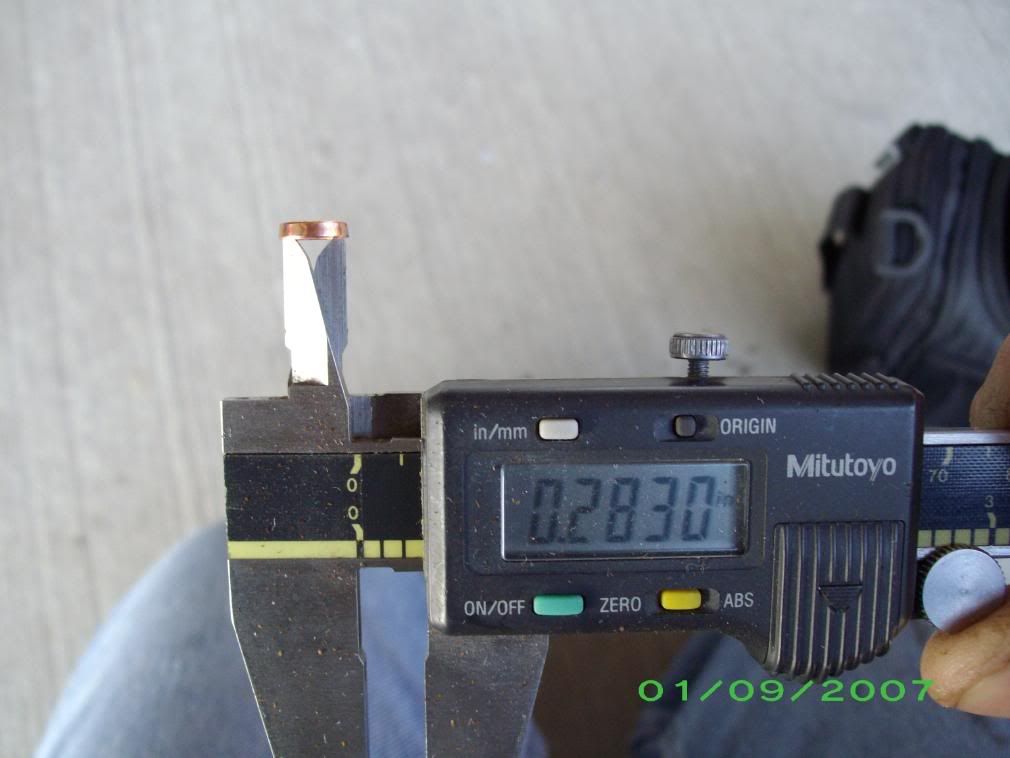

I measued a .30 cal gas check and I've emailed pics to my buddy. We'll see what he says when he gets back into work tomorrow. He'll probably tell me that it isn't worth getting a die made up, but who knows. Things are slowing down.
My email:
Hi Buddy. Here's your Monday morning headache LOL!!! Since I know there's a punch press around there somewhere that could use some extra work............ :)
1. Could you make these little copper cups??
2. How much would it be if we ordered say, 250,000 of them....or is it not even worth setting up??? If not, how many would we have to order to make it worth while?
Here are some pics with measurements
http://i207.photobucket.com/albums/bb93/blacksmithden/BulletsMay112008004.jpg
http://i207.photobucket.com/albums/bb93/blacksmithden/BulletsMay112008005.jpg
http://i207.photobucket.com/albums/bb93/blacksmithden/BulletsMay112008006.jpg
http://i207.photobucket.com/albums/bb93/blacksmithden/BulletsMay112008007.jpg
http://i207.photobucket.com/albums/bb93/blacksmithden/BulletsMay112008008.jpg
The 0.0545 is the depth of the inside of the cup
The ID of the cup and the side wall thickness would have to be within .001" or so.
The could be a little deeper if need be, but not much shallower.
Take care.
Den......

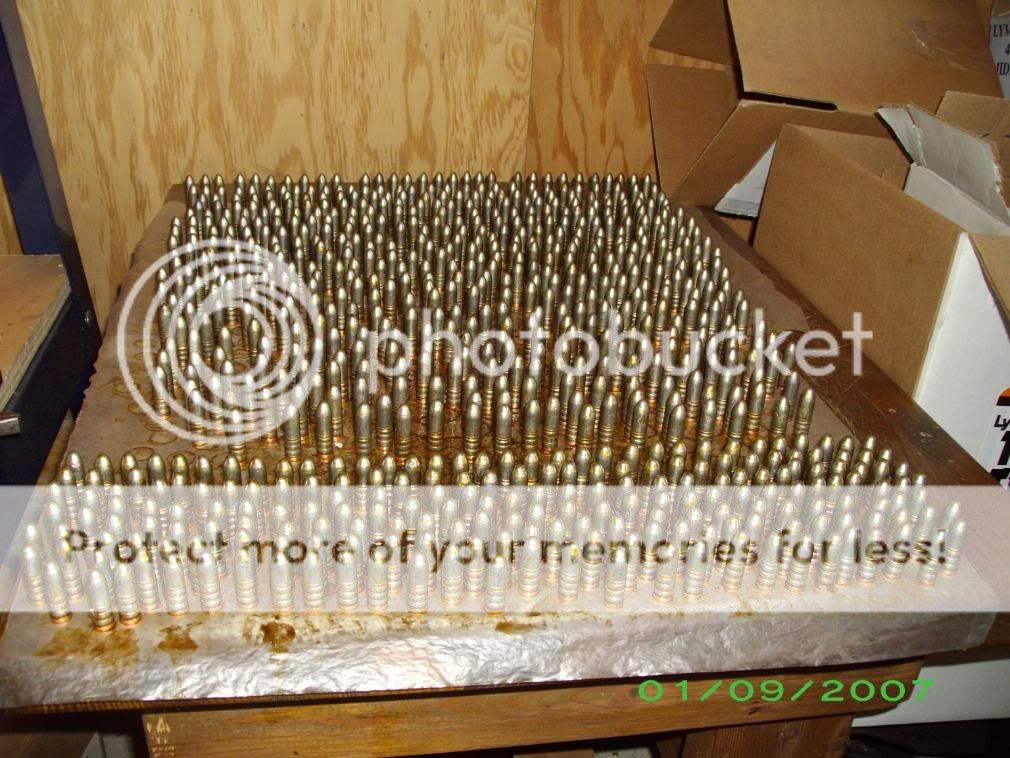

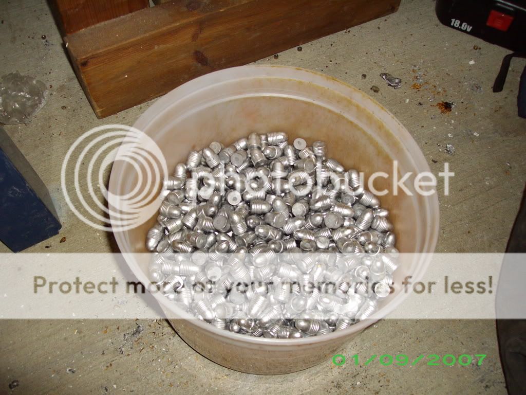

This weekends booty from Den's bullet factory (garage :D)
Where all those gas checks go.
I also cast about 1200 45's just because. I'm gonna have to sell some of these things soon. I think I've got around 2000 already sized and lubed, and now these. I just love using that particular mold because the bullets fall out as soon as you open it.
