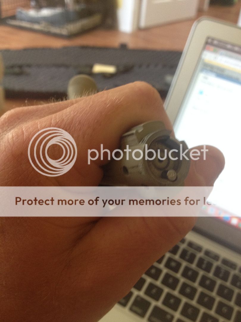

Sooo just got my rifle in mail after some cerakote work.
I put a full 20 round box of Federal Reds through it with amazing results!
I then moved onto trying some Doubletap Nosler Accubond ammunition.....I only put one round downrange and had a problem. When I tried to open the bolt to eject the casing the bolt was stuck....I did manage to get it open and this is what I found.
I unloaded the rifle....and inspected the chamber, bolt face, etc for any signs of damage, but couldn't find any.
I put some more rounds through the rifle (hornady SST) and noticed that the accuracy was significantly affected. The groupings opened up a good 3-4 inches.
Here are some more pictures. Please, if you have any advice let me know....really stuck on this one!
Anything I should be looking for damage wise Jerry?
Just trying to narrow it down as to why the grouping have opened up as much as they did!
I did only us the hornady rounds after the blowout though....
Clean the boltface and look for pitting that can be caused by blown primers. That's about it. The other ammo could of just shot poorly. I had some Hornady Match 75gr .223 that would blow primers and shot the worst of all factory .223 I've shot.

You will need to try the ammo that gave you good results again, I bet it will be back to normal, I only use factory match ammo in my .308 and get 1/4 MOA with stuff it likes up to 2-2-1/2 MOA at 100 yards with stuff it does not.

I had a box of Federal Tactical 165gr do that, almost every 3rd or 5th round. In one instance, a primer got blown out and ended up down into the trigger mechanism and got lodged in there. Had to remove the mechanism to get it out.
But no damage was done to the rifle or bolt, so I just pulled the rest and kept the brass for my reloads.
Lucky that load wasn't much hotter or you would have have had a lot of gas coming back with that weakened extractor cut out.
