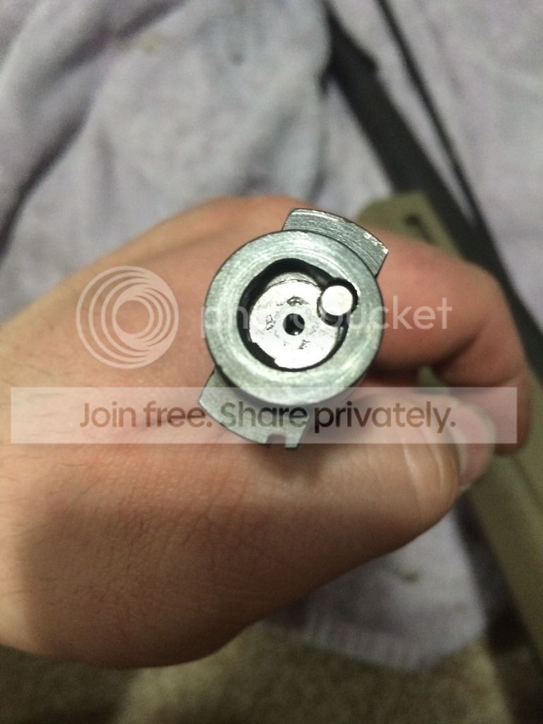

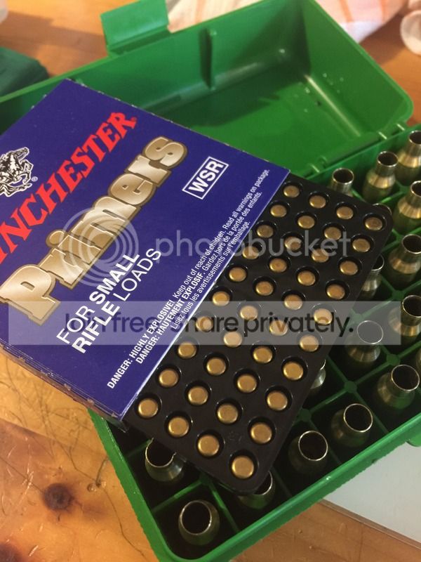

It has nothing to do with the brass, t's a known issue with Winchester primers, stop using them, or you will damage the bolt face even more.
I have heard this. Is this something occurring with new batches of Winchester primers? The Win primers I have are at least 6 years old and I don't have any issues.
I have noticed that in some rounds, they are hard to chamber. They go in the chamber easily, but take extra effort to lower the bolt lever and lock them in place. Could the chamber be tight and that be the cause of the increased pressure?

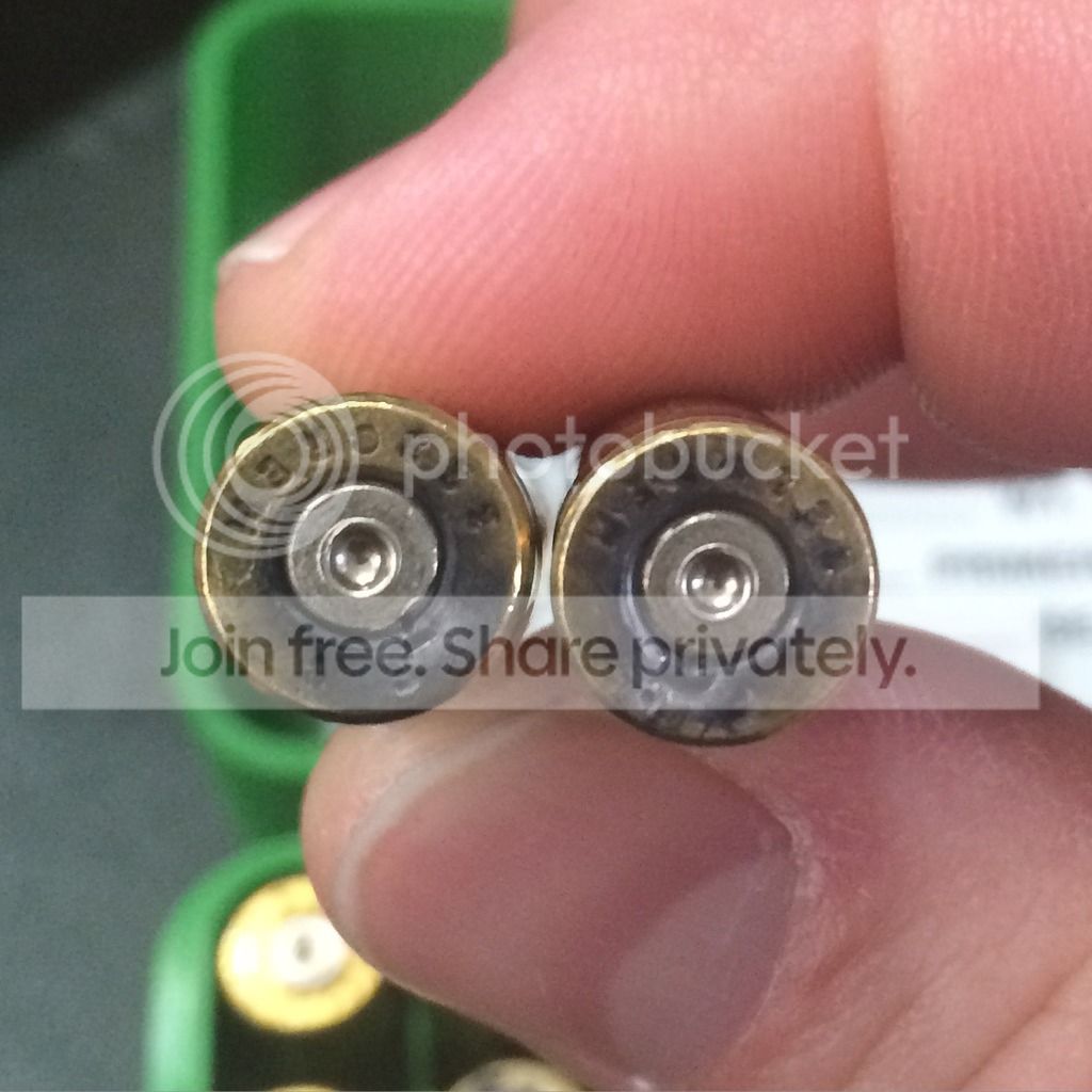

This has been discussed many times..........what you see is a primer cup failure.......period. It is not over pressured and the extruding at the pin hole is perfectly normal for most rifles now. No your bolt face is still perfectly service able but I would recommend a primer change. I have had this happen with WLRP but have never had a problem with CCIs. I use mostly all CCIs. The firing pin hole extrusion which is shown in the photos is not a pressure issue, when it is a pressure issue the entire section of the primer where the firing pin hole is in the bolt, raises up, even the dent from the pin is raised. It is easy to identify once you have seen it. Pressure failure of the primer pocket happens uniformly all the way around the primer and the whole case head is blackened and the primer usually falls out upon extraction.

Your problem has a lot to do with the Federal brass being noted for being soft "BUT" that's not the whole story. Federal .223 cases have a thinner flash hole web that allows the primer pocket to expand more than other cases. These type Federal cases are a real bad problem with reloaders who shoot AR15 rifles. The primer pockets loosen up and can score the bolt face and the primer can fall out and jam the trigger group.

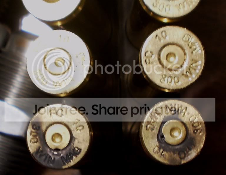

Below you can see the outside edges of the primer flattening out and becoming less rounded as the pressure builds when fired. This backing out puts extra strain on the primer edges and can cause them to rupture. Bottom line, the thinner primers are for lower pressure cartridges like the .22 Hornet and the thicker .025 cups are for high pressure cartridges.
Below is a exaggerated example of base expansion from high chamber pressure meaning beyond the elastic limits of the brass. You can also see how a thicker flash hole web adds strength to the base of the case.
Now use a black felt tip marker and blacken the base of your hard to chamber cases. If you see rub marks the base of the case expanded beyond limits and your cases are junk.

uncle ben, are you using mixed brass or is all your brass Federal .223 cases? You stated the cases with the blown primers were hard to chamber again and this indicates the base of the case has become oversized from over pressure.
Bottom line, I think the problem is your Federal brass and stretching brass.
Hey guys, I got a little bit of an update. Turns out I wasn't using cci primers after all. I was using No.6 1/2 Remington small rifle primers. I had a bunch of the No. 7 1/2 Remington bench rest primers, but used the others instead. I think the primers are the main culprit.
