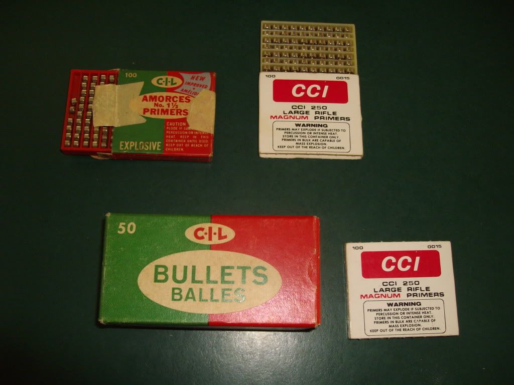

I have been storing primers in glass pickle jars for many years and they still work fine.
To give you an idea of how long, many of the boxes of CCI 250s still have price tags of .49 cents on them, which would make them mid 70s vintage.

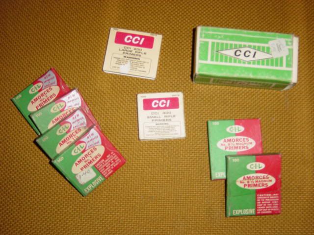

I just tested out a bunch that I got from an estate. Bruce (H4831) and I figured they were from the early 60's by the packaging and the price tags. They were CCI's and CIL's....in the original packaging.....sitting in an unheated garage just south of Edmonton Alberta. Not a misfire in the lot.
