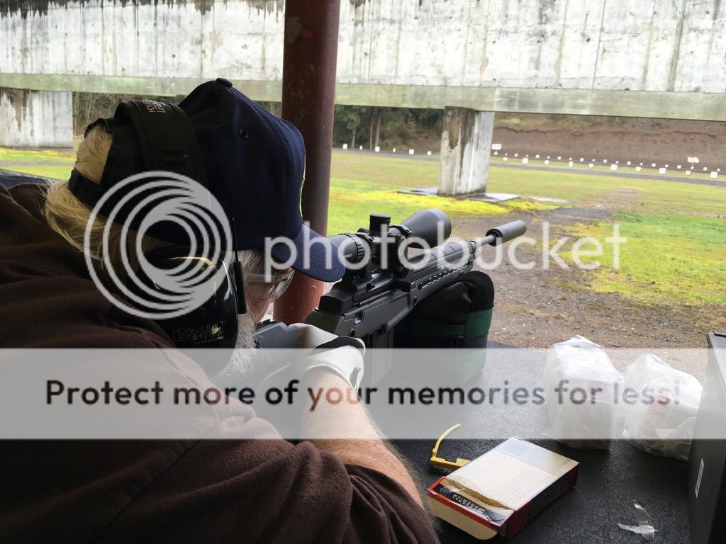

Probably the coolest gun I've ever built. The customer is very happy! Even with 175 FGMM, The rifle hardly moves. :cool:
The suppressor is a "SOLACE" 9 inch. The flash suppressor is a YHM Phantom M14 QD flash suppressor
Here's the breakdown:
Receiver: Bula XM21 (scope-only, no rear sights)
Bolt: Bula
Barrel: Jon Wolfe WMMW 5R/ Jon Wolfe chamber
Operating Rod: Bula
Operating Rod Spring Guide: Bula
Gas system: Bula
Gas Plug: Schuster
Trigger Housing: Bula
Trigger Guard: Bula
Misc Trigger parts: GI mix
Chassis: JAE-100 G3 Titanium Grey with side rails
Scope rings: Leupold MK4 extra-high
Scope: Night Force SHV 4-14x56mm
The rifle weighs about 17 pounds without the can on it, so I'd say around 19.5 to 20 pounds.
Tony.
Nice build Tony! I prefer having an iron sight as a backup even with a scope mounted, but that looks like a quality receiver.
