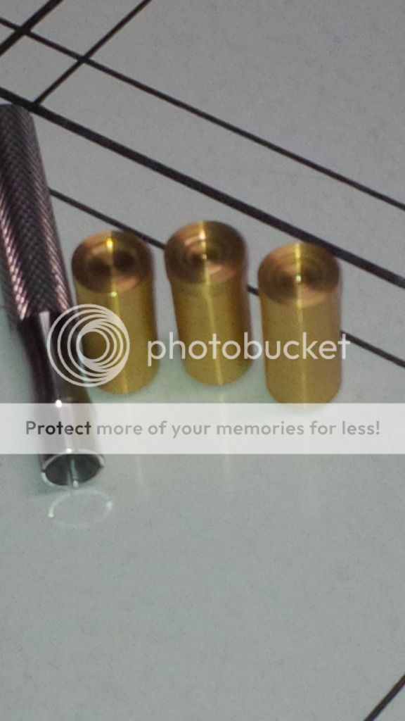

With the different mould makers and gas check makers, it's often hard to put the two together. The little tool on the left, breaks the edge of the gas check shank, so the checks will mate properly. It's made by NOE. Sometimes, that isn't enough and it's hard to get the checks on squarely with just your thumb, especially elderly thumbs with arthritis. I made up a few of the "dies" as shown. Used in the sizer/luber, all they do is push the check on squarely to the base. They do not crimp the check in place. One just does .45/70 bullets and the others do .45 and .30 cals. By sitting in the recess, they are centred with the top punch of the sizer. I made these out of brass. It's a simple job and a semi-skilled lathe operator could do one in about twenty minutes. The last one I did took just under two hours.
Can certainly appreciate the craftsmanship Slug. Would really like to keep away from any extra efforts as making the tiny bullets is work enough then there's the two step process of forming checks. Did try passing the bullets check first through the sizer and had no real luck. Most of the bullets were simply folded and sheared from the force taken to size the check down. The bullets that did make it through are noticeably deflected with unsquare checks. Think I'll try a thinner gauge aluminum before I get into reaming the sizer. Did smooth out the taper where bullet feeds into the die which seemed to alleviate some pressure. Anyways will try out the thinner stock and hopefully that will give me the proper results without having to do any extra work on the die.
I'll make some new checks with the thinner material and if I'm still without luck I may just take you up on the offer Slug. Either way thank you very much for the offer and insightful info.
