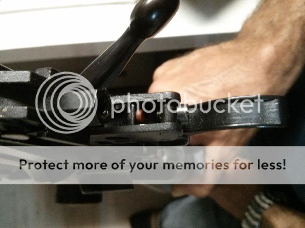

After taking the action out of the stock and looking closely, I see that the adjustment screw isn't in contact with anything. It appears as thought a piece may be missing.

Here is a pic of the adjustment screw in question and the space beneath it. I figure I'm beating a dead horse here but I'm getting nothing back from Browning as of yet so what the heck.
That is odd that the screw is supposed to adjust the primary trigger pull. I have a number of single shot rifles with single and double set triggers and the set screw only adjusts the pull when the trigger is set. The trigger also should not jump when it lets off. A properly functioning set trigger feels the same as a good single trigger but much lighter.
