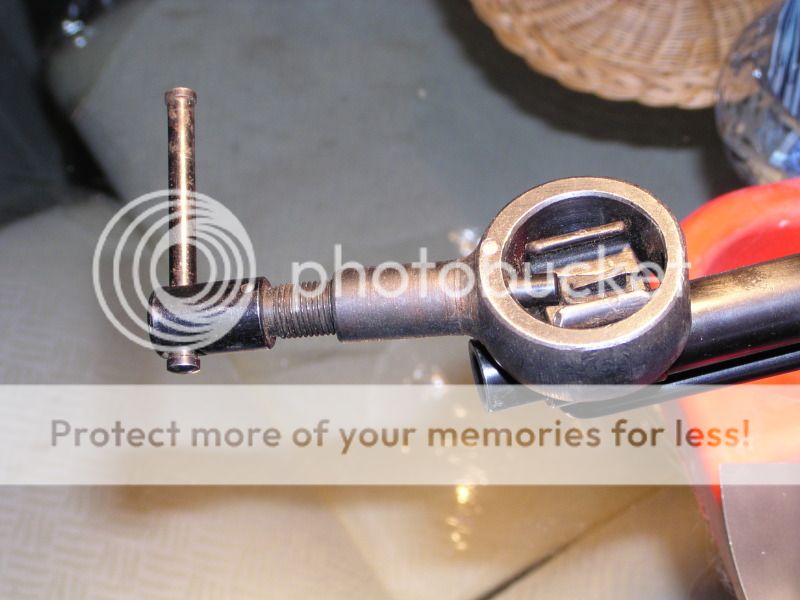

A small nut splitter from Crappy Tire will do the job. Just grind down the sharp bit to fit the foresight blade.

tac
I found this one at a gun show, the guy didn't know what it was :)

Are you trying to tap it over from the side?
We are used to a "dovetail" front sight that moves from side to side. The K31 sight is at an angle front to back, and the sight must be moved forward or backwards to get windage because it moves in an angled cut in the sight base. FORWARD moves the sight to the RIGHT, and BACKWARDS moves the sight to the LEFT.
If you look at the sight tool in the picture posted by POLARIS you will see that the "pusher" is at such an angle.

I went an even easier and cheaper route than using a nut splitter. I used a shaft collar and a 5/16 bolt. All I had to is file of the threads from the start of the bolt so it fits in the groove. It works amazing and it ended up only costing me $4. It looks pretty professional too
