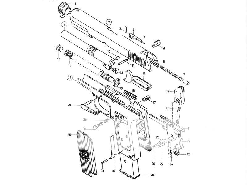

This be the correct exploded view....not the Airsoft version....christ lol

Your parts diagram looks to be for an airsoft gun.
EDIT: All Better now
Hopefully that's all it is. If Russian parts fit, it's an $8 fix from tradex. Part 24 in the exploded view I posted above.

Looks like I need to order (if possible) the disconnect for an M88..Looks exactly the same. The Russian Tokarev part looks totally different..The disconnect definately looks worn (or even a small part has sheared off) at the bottom...Good call, thanks again.
That looks better:)) Yep, its the same...Thanks guys..I'll order it with Tradex...
Thats what sucks about doing :bigHug::bigHug::bigHug::bigHug: with my phone...can hardly see what I'm doing! Airsoft parts....jesus :)
