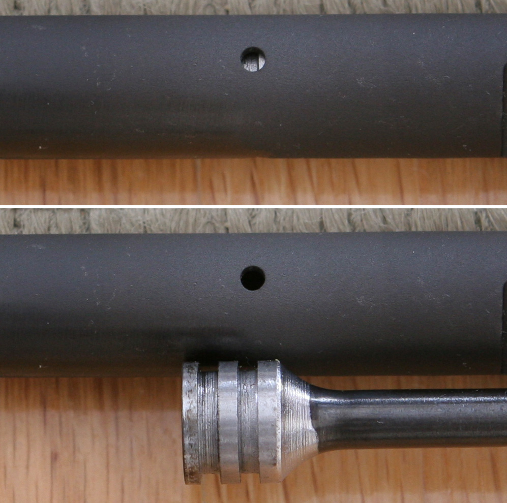

I havn't cleaned my SKS properly immediately (corrosive ammo!! :bangHead:), and after 3 days I had gas piston stuck in the gas tube.
Finally I managed to hammer it out, but then I noticed that gas piston cannot go to till the end - it gets stuck in the middle..
What is recommended to get the rust out?

If I recall correctly, the inside of the gas tube is slightly tapered, so it doesn't go all the way to the end of the tube, only about half way or 2/3rds.
Try a bore brush and oil, don't use sandpaper.

ok, but should it go back so piston would completely open those 2 holes in the tube?
Here it moves only till the first groove - see pic how far it moves:

jt_trouble is correct .
SKS is a short stroke gas system so no matter how far the piston moves rearward , it wont move further than the piston extension which will only moves about 3/4" to 7/8 " . try it by removing the piston extension spring and drop the piston extension and see how far it protrudes.
now about the holes on the gas tube , they are not gas escape ports. they are located too far back for that , they are there to reduce pressure behind the piston head as the gas pushes the head rearward.
Thank you - this perfectly makes sense!
Yes, I've measured - the piston extension can be moved only 18mm, and my piston "got stuck" at 42mm, so no way this affects operating.
So as the summary - it's really not that easy to damage/destroy SKS with poor cleaning :)
