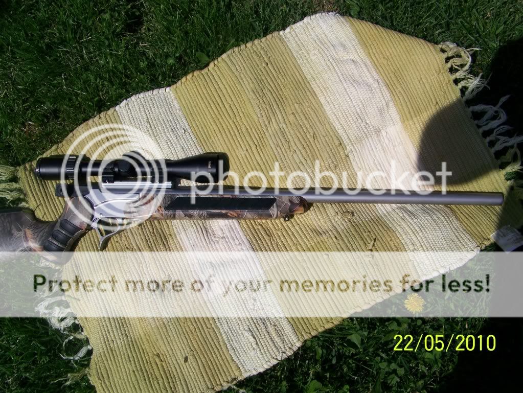

OK. Thanks for the info guys. I ended up tapering the barrel blank myself on an antique lathe. It looks pretty nice and no CNC, taper attachment or steady-rest was required, but if I had paid someone by the hour to do it this way, I'd be broke.
