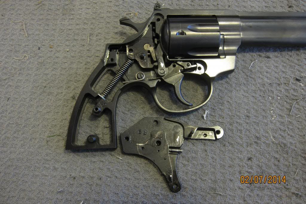

Took the plate off the side and cleaned and greased up the trigger mechanisms. Updates in blue

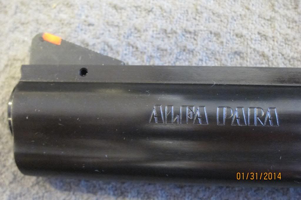

Finish
· Overall Finish is a little bit below that of my Ruger Blackhawk.
· Bluing is a nice even satin.
· Some of the lettering and proof marks look a bit crude.

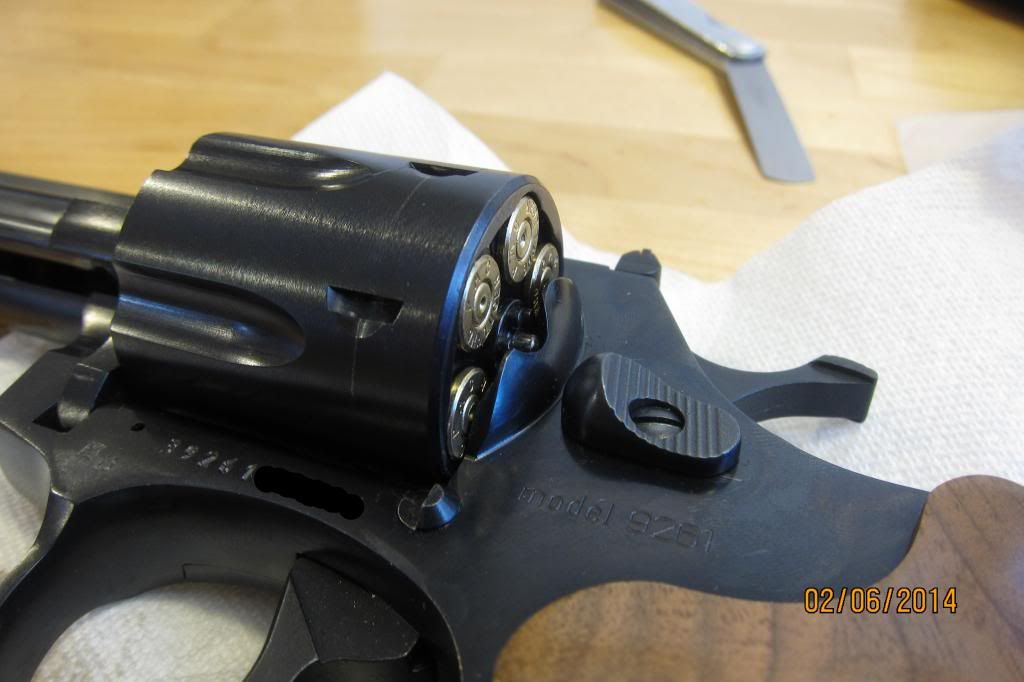

· Machining marks:
· Internal surfaces nicely machined too - see pics below

Side plate removal and Trigger Assembly

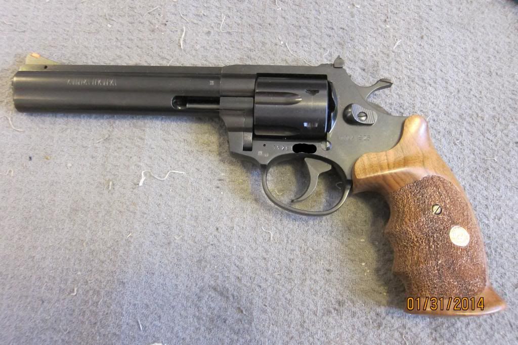

With the stippled wood grips installed

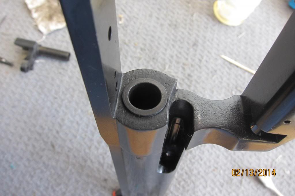

Bore looks good with a nice crown

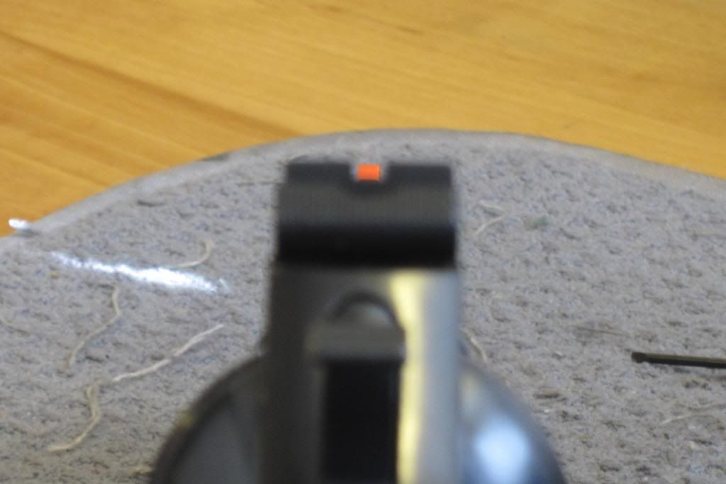

Really liking that front sight
Doh! These sights are a little tougher to use on the flourescent orange 6" dia stickers I like to use as targets. Good thing it shoots accurately enough that I can use the flourescent green 3" dia stickers.

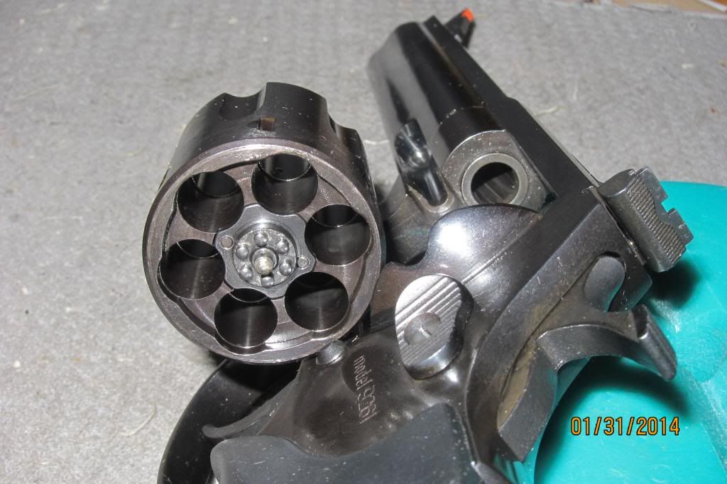

Slight machining marks left on the cylinder face

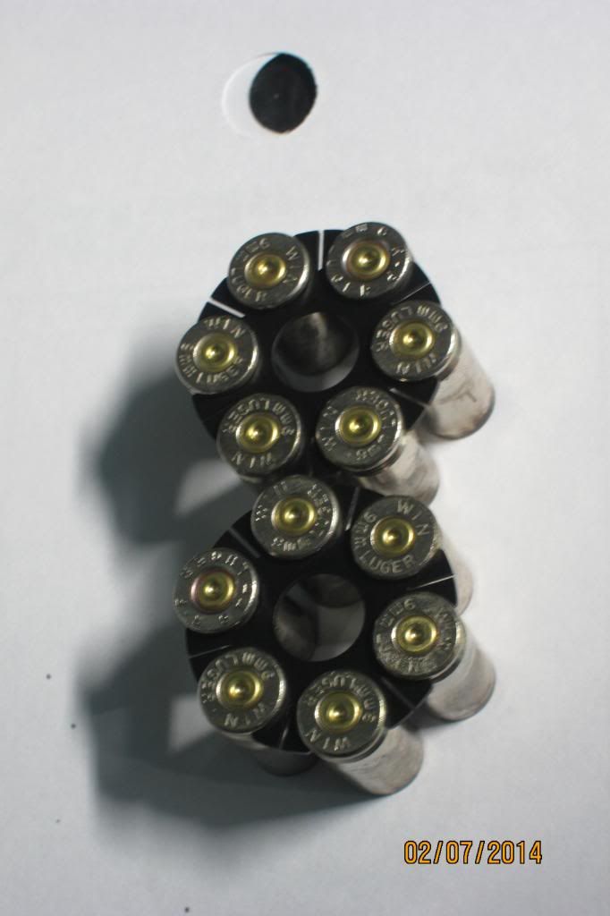

Loaded with spent casings using the moon clip. Bottom of the cases are flush with the bottom rim of the cylinder. Gap from the cylinder face to the back frame firing pin are is ~0.08mm measured with a slip gauge.

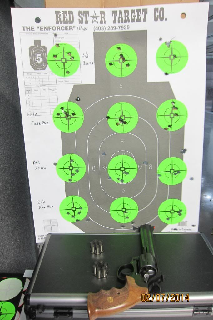

First Range outing shooting results 10 yards, 6 shot per 3" dia target (turns out I suck at shooting off the bench)
Tried some other guns for reference during this range trip (Ruger Blackhawk 45acp, Ruger 22/45, CZ75 SP01 Shadow)

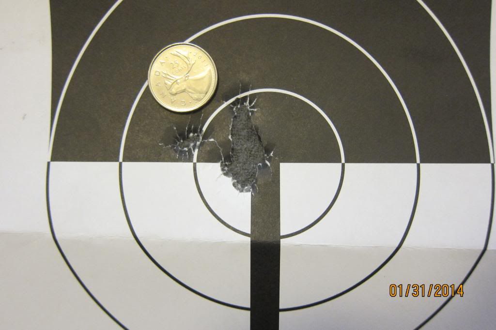

Some pretty deep strikes on these primers using the stock mainspring

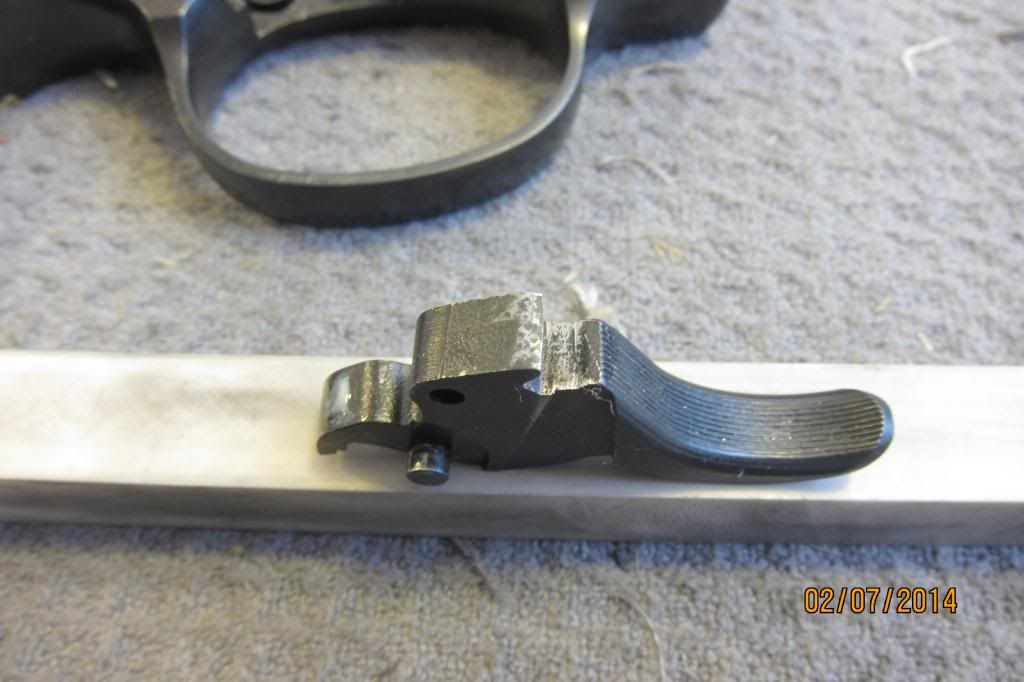

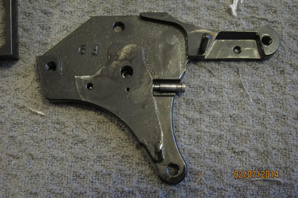

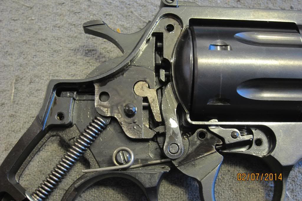

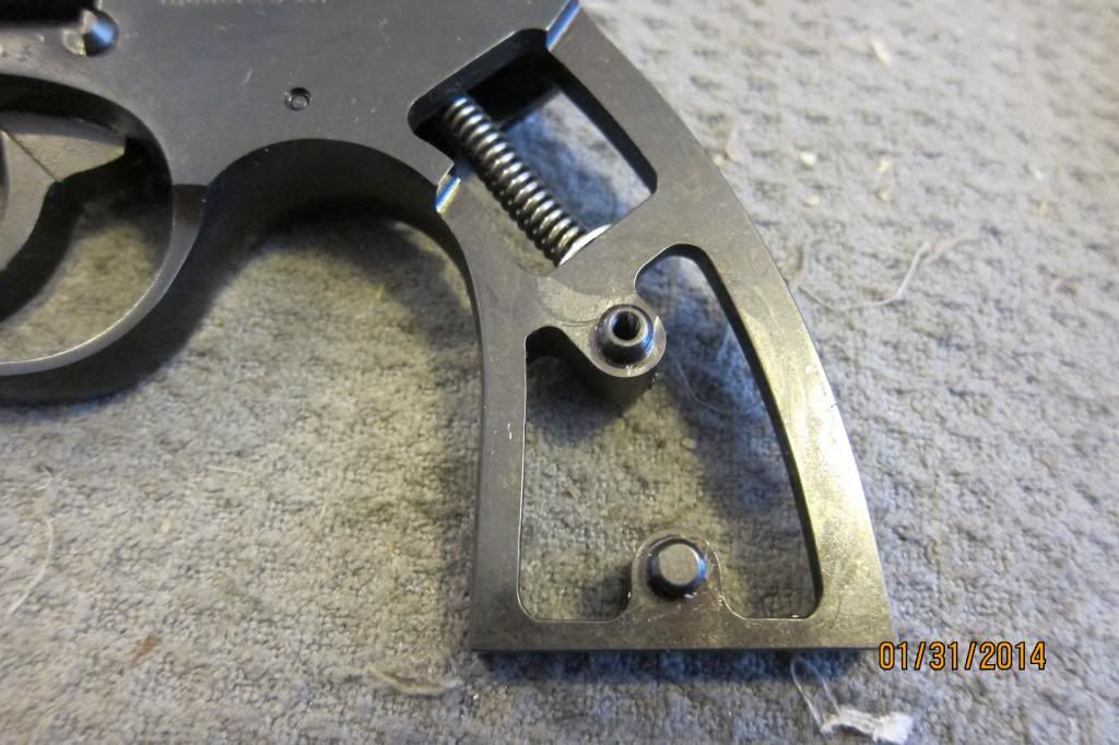

Side plate removed

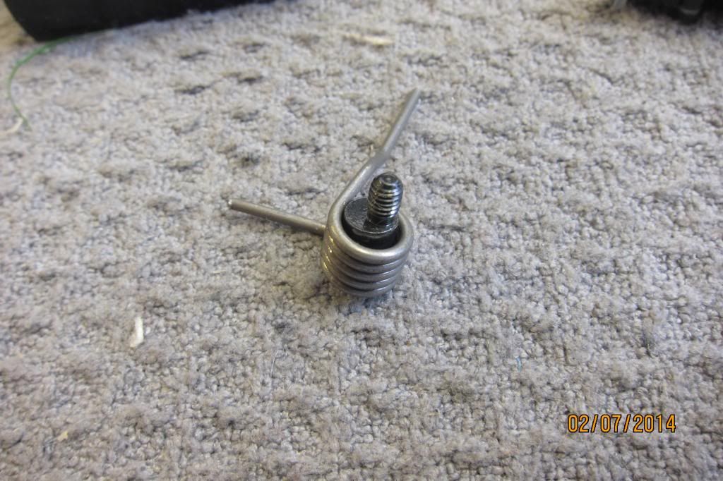

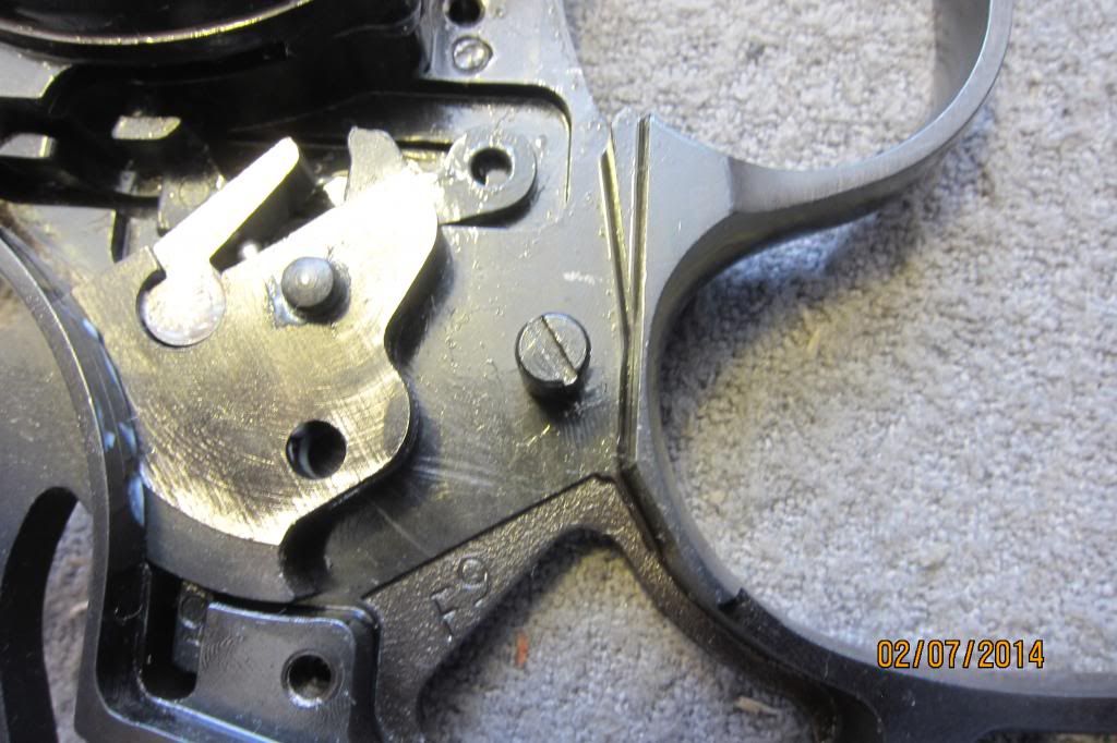

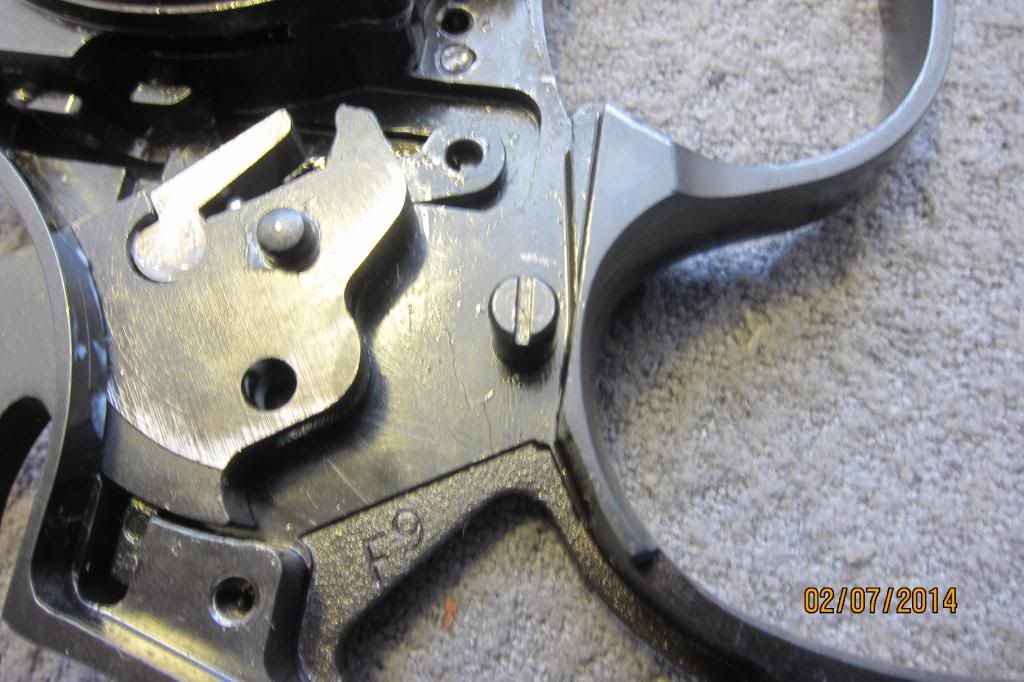

The Trigger Return Spring post is cut with an eccentric cam profile
Looks like the Trigger Return Spring can be adjusted, but going to leave it set in the factory stock position for now.

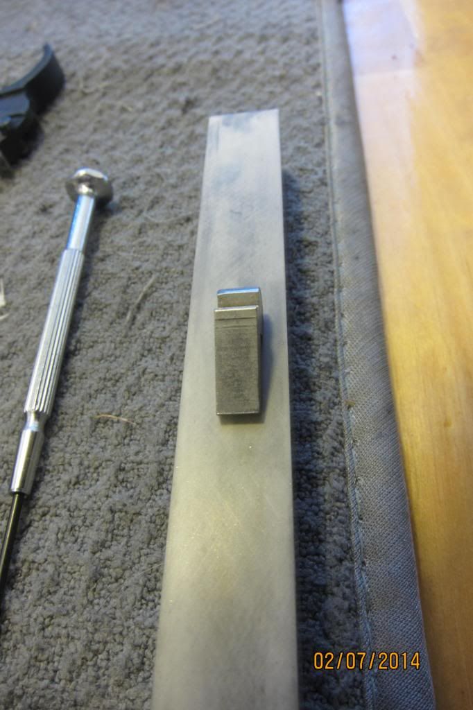

The trigger parts and surfaces I gave a very light polish to

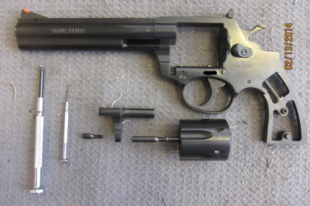

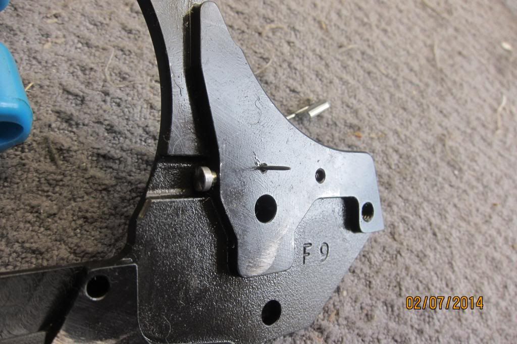

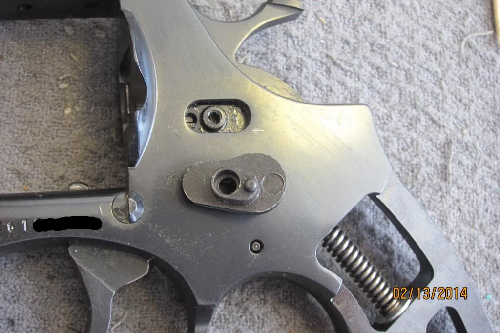

Locking back the pin that pushes against the arm that indexes the cylinder. Needs to be done for putting the side plate back on.

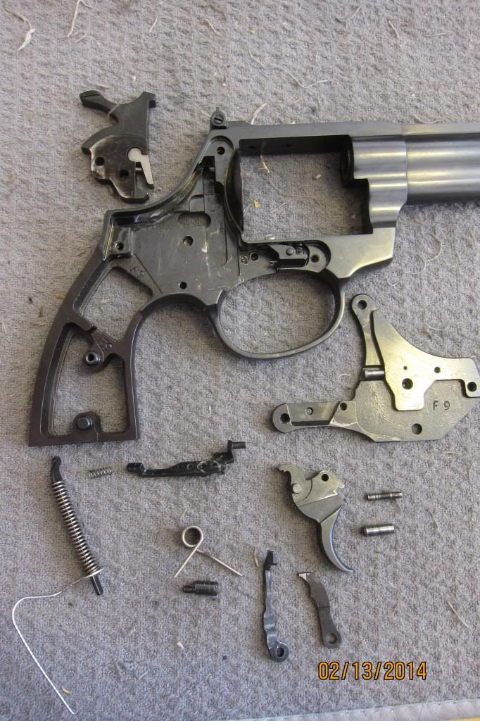

Field stripping the Alpha apart for a good clean (you need a small diameter pin to keep the capture nut from rotating when you unscrew that pivot bolt)
So far the only sloppy part I've found on this revolver. The underside of the thumb piece was just as cast and a little rough. A little stoning makes it nice and easy to release the cylinder

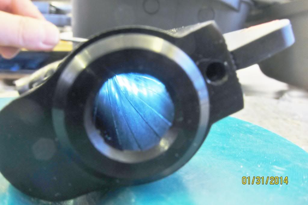

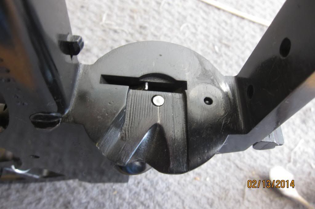

A few shots of the forcing cone and firing pin/shrowd
Detail strip of the trigger mechanism - before the stoning & polishing
A retest of the trigger pull (S/A & D/A) after the trigger and moving parts polish. Also had the trigger return spring set to it's weakest position

Finish
o Starting to develop some slight drag marks around the cylinder from dry firing ~200 times. I have them on my Ruger Blackhawk too, so assuming this kind of wear is pretty normal.
· Most of the edges are nicely finished. The only sharp edge I found was on the barrel lug cut-out for the cylinder ejector rod. · Some of the lettering and proof marks look a bit crude.
· Machining marks:
o Barely noticeable on the outer surfaces of the revolver and very even.
o Areas under the grips are well finished too.
o Haven't taken the side plate off yet, so will update later what I find there.
o Just a little rough on the face of the cylinder. Some visible machining marks, but not too rough and all edges de-burred.
· Barrel bore is nicely crowned o Areas under the grips are well finished too.

· Front sights - I am LOVING the bright orange plastic insert. Much easier sight picture for my tired old eyes. Going to see if I can get something similar for my Rugers.
· In a two handed grip, there's very little gap between the front sight and the inner edges of the rear sight blade.
o For target shooting, this should be fine, but for anything requiring fast target acquisition, may be a challenge.
o Probably easy to fix with a little judicious needle filing of the rear sight blade.
Side plate takes off pretty easy by removing 3 screws. It's in pretty snug and needs a little bit of wiggly and careful prying to get it off.
[*=1]Very well oiled. I cleaned it all up anyhow and relubricated with some lithium grease.
[*=1]The trigger assembly cavity and side plate are very well finished. No rough machining marks, and cast surfaces have a very fine grain. A very good sign of quality.
[*=1]To put the side plate back on, you have to push in and block the pin that pushes against the arm that indexes the cylinder for firing. There's no mention of this in the included manual - wich is pretty skimpy actually. It takes a very small paper clip. I just used a safety pin that was handy. Be very careful here! If you accidentally let that pin loose, it and the spring fly about 10' .....

[*=1]It's my first look at a double action trigger assembly, but could easily see the contact surfaces in play during the trigger reset. Couldn't resist, and did a very light polish with a fine ceramic stone. Trigger return is a lot smoother now. Have attached pic's below.
[*=1]Will probably go back later and do a full polish on all the moving trigger parts (sides and contact areas). I did this on my Norinco 1911 trigger and while it may not have made a huge difference, it just seemed like a good thing to do.
[*=1]Will leave the single action sear engagement point alone as the current 5lb break is just fine for me.

- polished all moving parts in the trigger (hammer, sear, trigger). Sides and contact surfaces (except the sear and trigger single action contact points)
- adjusted the trigger return spring to weakest position. There is an access hole in the side plate, so this can be adjusted just by removing the right side grip.
- polished sides and contact surfaces of internal parts (hammer block, hand, bolt)
- stoned the underside of the thumb piece that you push to release the cylinder (the underside was really rough - see pic below)
Finish under the grips is pretty good. Hopefully an indicator of overall good quality
Side plate removed
