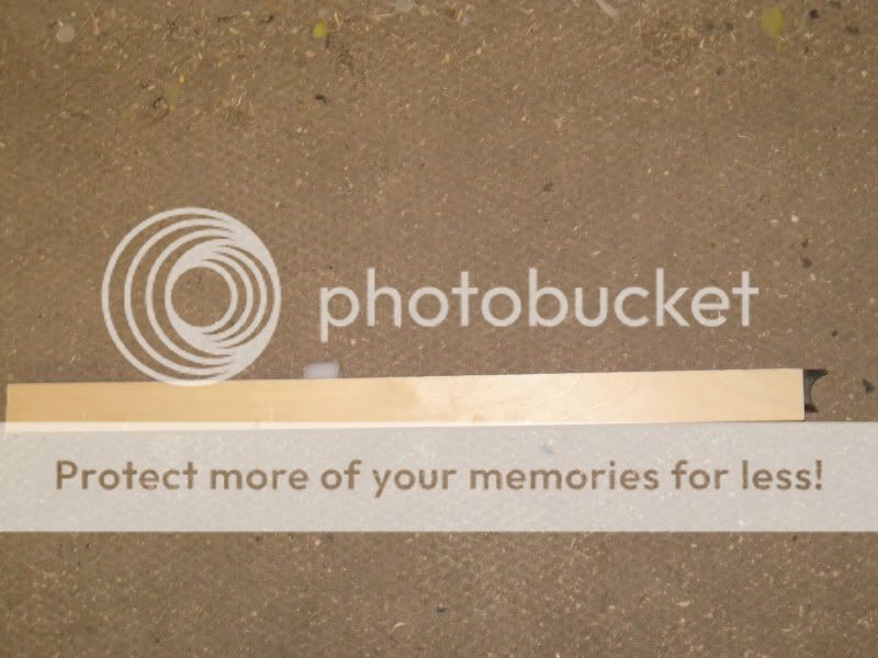

Then, I glued up the piece for the fore arm, and I assembled the rounded part at the end of it

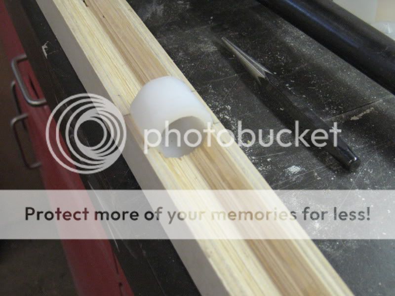

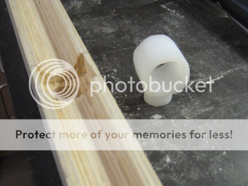

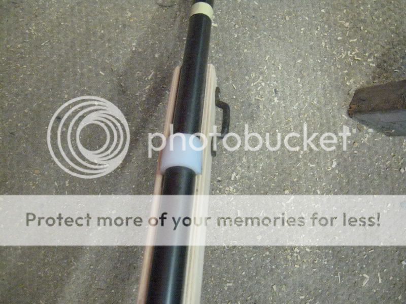

Next, how to hold the barrel with something else than duct-tape ? I took inspiration from the inner band that is on my Lee Enfield, and I took some UHMW and made a ring.
Then I carved the recess to receive it, I tapped a screw under it, and now I can squeeze the barrel home.

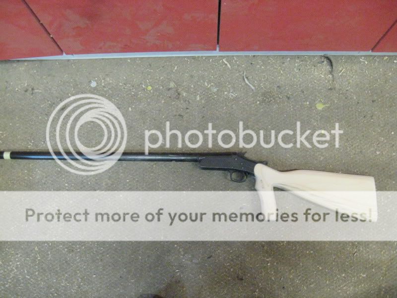

And here is the gun as it is tonight, with some Jeep loop to attach a sling. I will cut the barrel to about where the tape is ( around 20 inches or so...)
I hope you like it, next will be my first attempt at winter camo....

looks good if it were me tho i would have made the grip closer to the trigger it looks awkward the way it is
Yeah I hear you. However it has to do with the way the action is built. And it is not that bad to hold on. In fact, I can move the hammer (again, I lack the good terminology) quicker this way.
