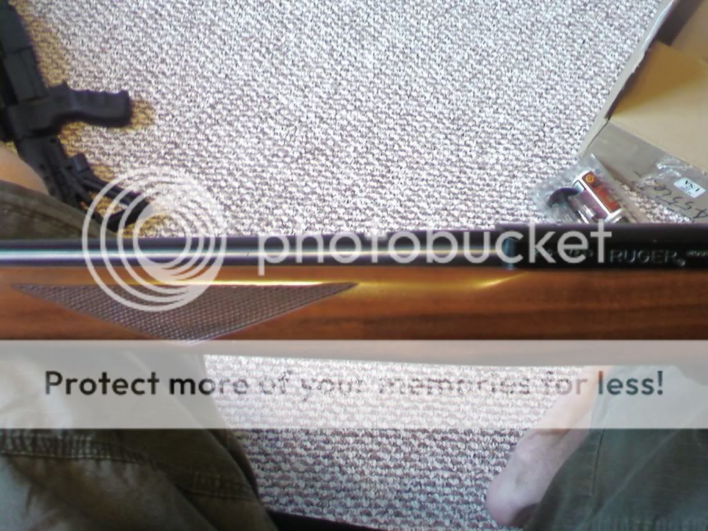

The first step is to remove the iron sights from the barrel. If you are planning on using an aftermarket barrel, you can skip this step.

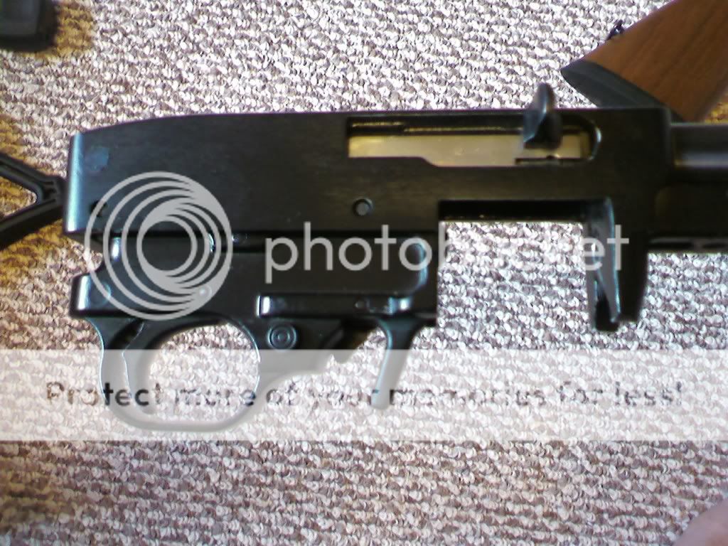

With the sights removed, I removed the barreled action from the wood stock and replaced the mag release with the aluminum extended mag release included in the kit. Simply press out the pin the holds the mag release and the bolt stop in place and pull out the mag release. This step was very easy and only took about two minutes.

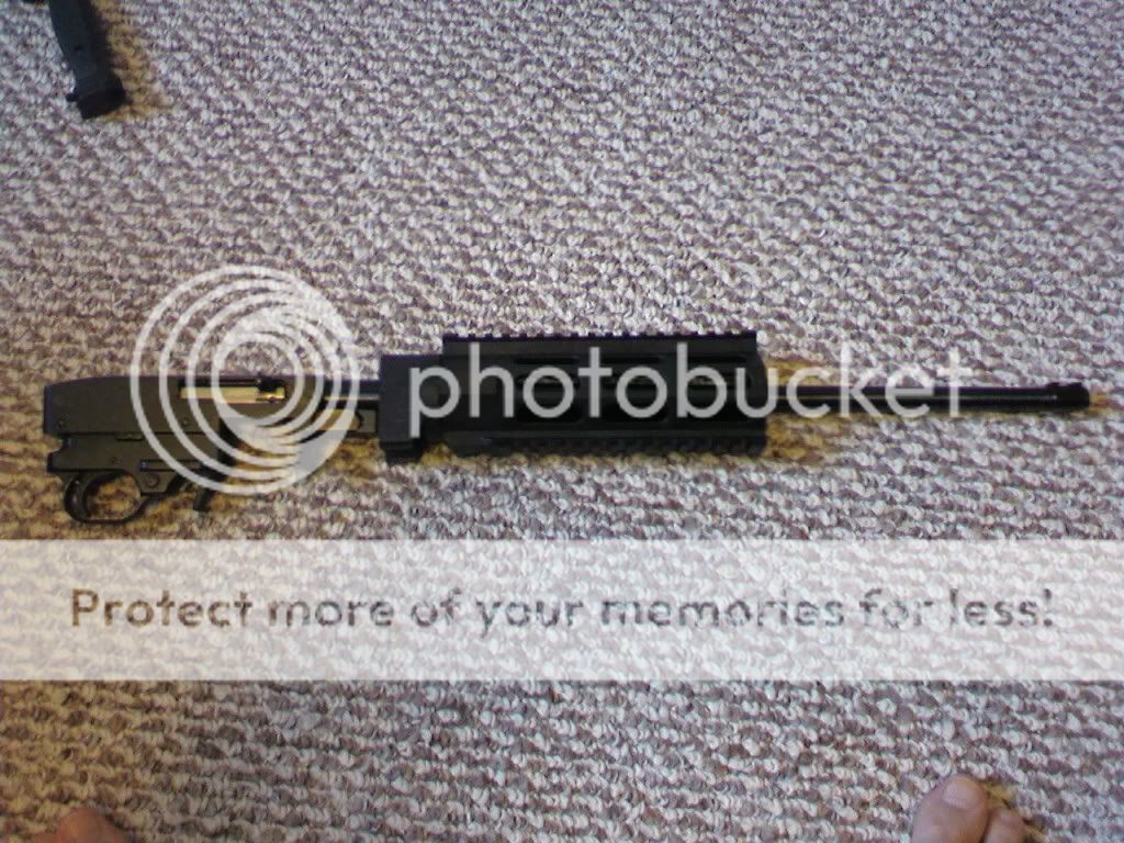

The next step is to slide the forend onto the barrel. This is important because the next step is installing the front sight mount and once that mount is on, you would have to remove the barrel from the action to install the forend.

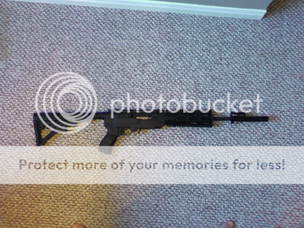

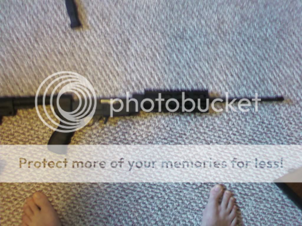

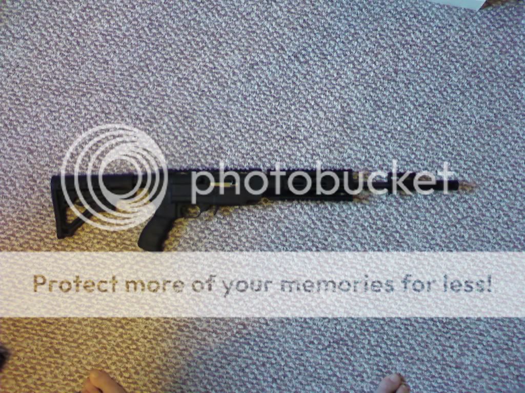

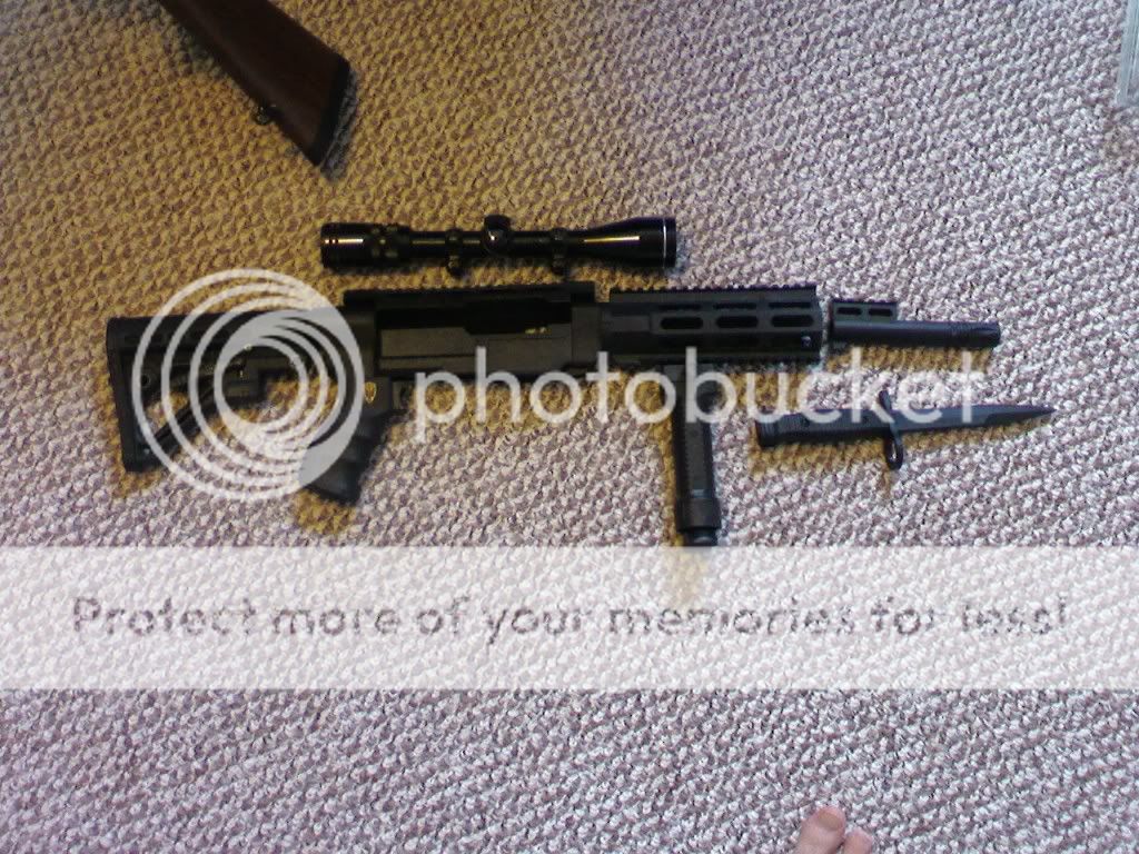

I installed the action into the new stock to check the fit. I waited to install the front sight mount until I had the receiver mounted in the stock. You can see that the forend does not line up very well. When tightening the front capscrews it will start pulling the front down. I later fixed this by tightening the top rail to the receiver first, then the forend to the top rail. If you wanted you could shim up the front. I may do this later once I see how everything is after putting several hundred rounds though it.
You can see in these pictures that most of the forend drop has been resolved. I think I will make up an aluminum shim to prop it back up.

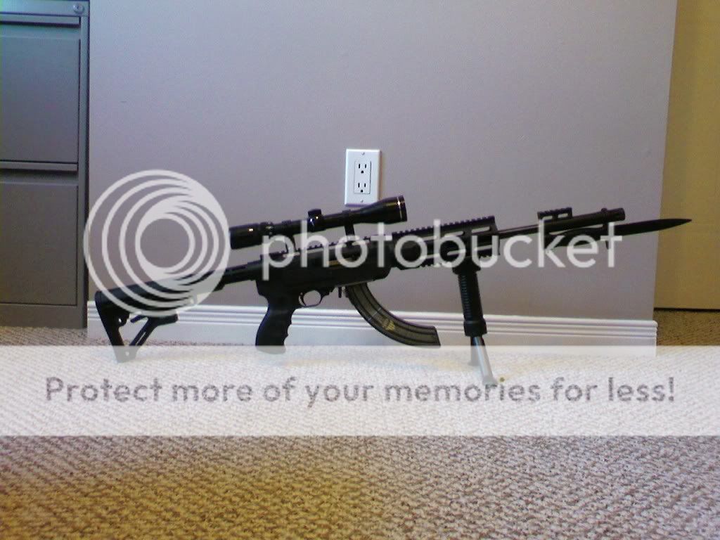

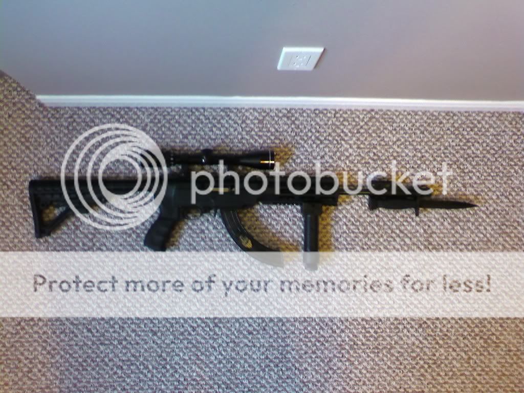

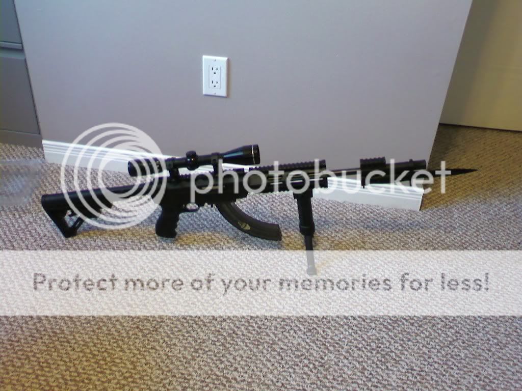

This is the final product. I installed a Tasco 3-9x30 scope and a foregrip that has an integrated bipod. The foregrip is just a chinese knockoff from ebay. But it only cost $12 including shipping so I'm not about to complain. The bayonet is included in the kit, but it's just made out of the same plastic as the stock. Looks cool though.
