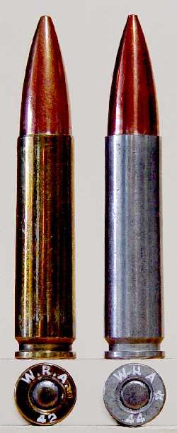

30 Carbine sample
You find these and similar frequently in cartridge collecting.
