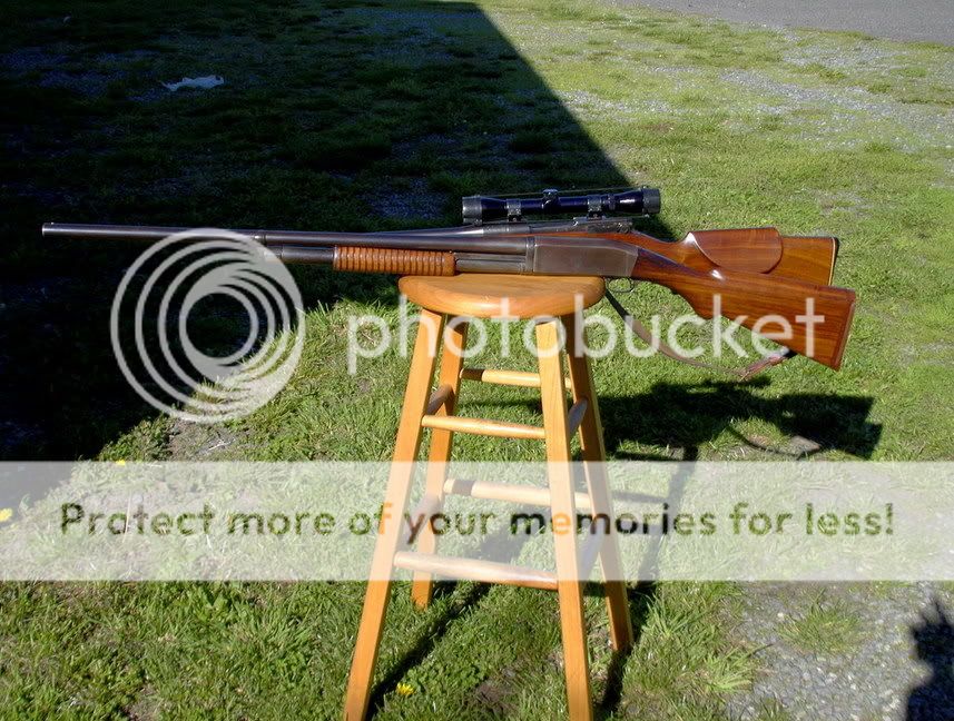

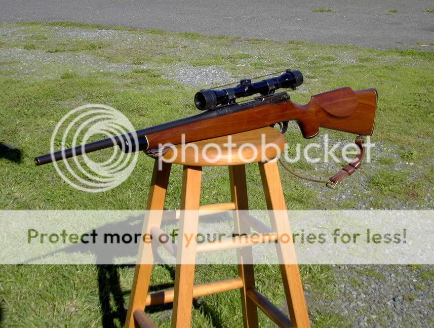

Here is a sample of a finished P-14 sporter that has about 20 coats rubbed in.
