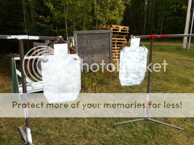

First up is a bit of a hodgepodge. The silhouettes are IPSC metric targets in 1/2" AR500. The stands are a two-piece design normally used to hold a 16x22" fixed plate. The bases have a socket that the post fits into. The plate has a stub welded to the back that fits into the socket on the top of the post. The pic shows how I've used a second post through the top socket to provide somewhere to hang the plate from. We'll be shooting slugs at these in FSJ on the 13th and at the PR team match in October.

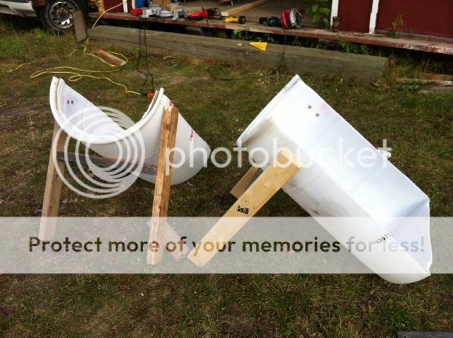

Next is a "dump bin" (anyone have a better name for them?) for long guns. 3 pieces of 2x4 and half a plastic barrel each. It took about half an hour to make two. You could screw a small pail in on the side to provide somewhere to ditch a pistol, too. I've built another dump bin design that's made out of 2x2 or 2x4 and plywood, but these are a lot quicker to build.

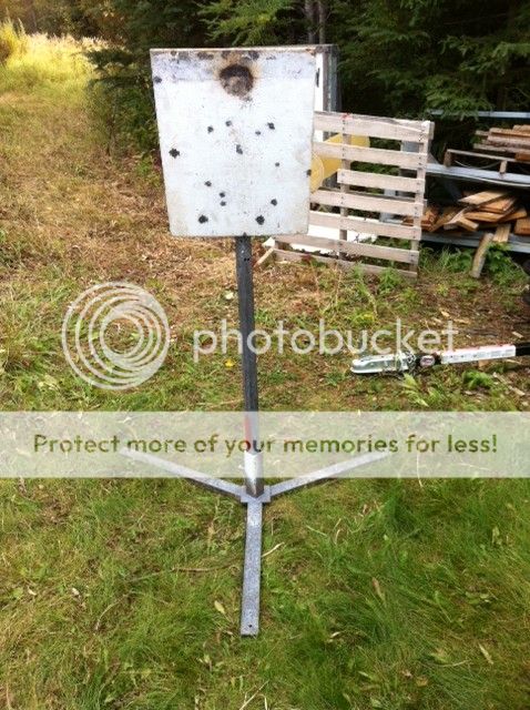

This is the plate stand that I used to kludge together the IPSC steel hanger. The plate is 3/8" thick, 16x22" AR500. It has an angle-cut stub welded on the back to fit into the "receiver" on the top of the post. They've been mostly used for courses where distance or circumstances, like a longer range carbine or shotgun classes, make them a better option than cardboard.
We've been using 12 of them for 4 years and this spring had to replace the stub on the plate on most. They had a hollow square tube stub and most had broken off or split on the corners due to vibration. The hollow tube was replaced with solid bar stock.
They've got about a 15 degree angle to deflect downwards. They've taken multiple thousands of hits each of rifle, including steel core, pistol and shotgun rounds.

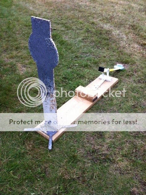

This is one of our welfare clay pigeon flippers. It's a homemade large popper and an MGM flipper attachment, both bolted to a piece of 2x8 lumber. The 2x8 has a couple of chunks of 2x4 screwed together to act as bumper for the popper and holes drilled in it to allow it to be spiked down to eliminate movement.
We have plowed all of the proceeds from our matches back into targets and we are starting to get a pretty good collection.

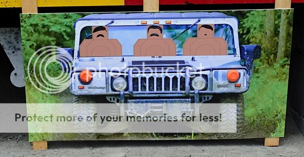

With the "Hummer from Hell" target, shooters had to shoot out the "lights"(clays) with their rifle, shoot out the tires while on the move (also with the rifle), then shoot the rad with their shotgun (slugs), and finally take out the 3 occupants with their handgun. It's a fun target to shoot :)

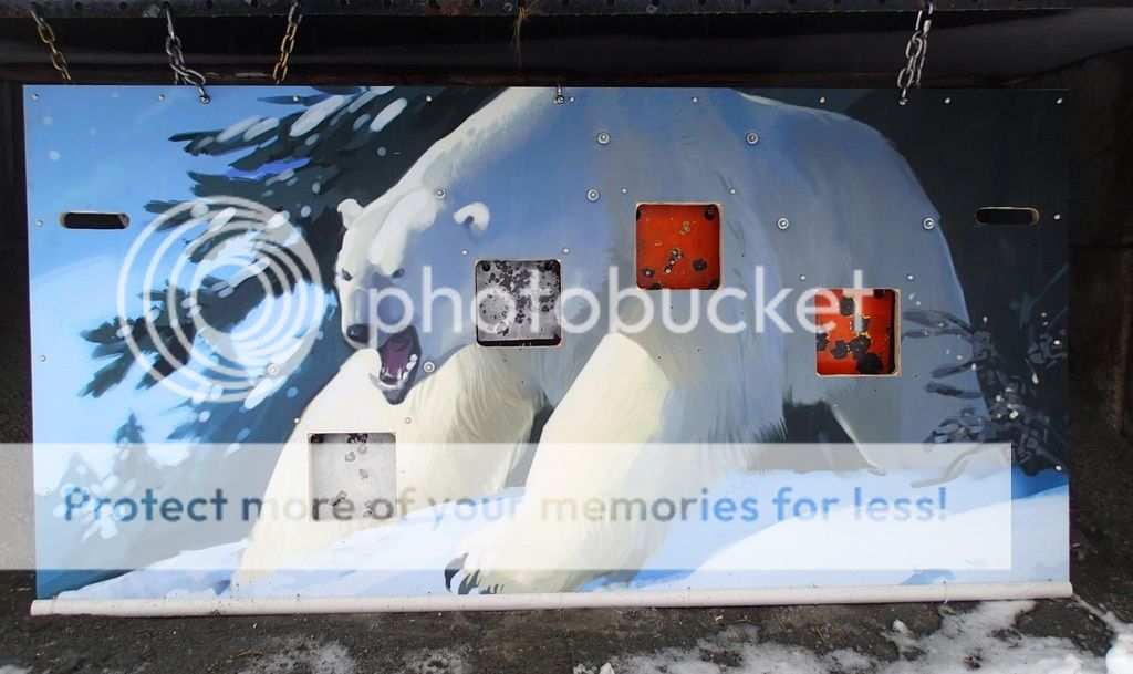

At our Winter Match, shooters had to take out the Polar bear while lying prone on a toboggan...later in the winter while using said toboggan, my wife wondered where all of those black marks (powder burns) came from :D

As for the dump barrels, make sure you have a piece of carpet or cardboard on the bottom. Few guys I was shooting with had melted pieces of plastic getting stuck on their muzzle brakes after dumping a hot rifle.
Printed, just like the Hummer. Local shop does them for a pretty reasonable price. They won't last forever but we get several 3-gun practices and matches out of them.
For the shots on the tires and rad, do you just look for holes in the print or is there steel behind it that rings?
The first few times we used it, we just looked for holes and patched them. Shooters just had to put one rifle round through the tire while moving towards the vehicle so most shooters emptied a mag between the two tires just to be sure they had a hit. For the rad, shooters could take a maximum of two shots with slugs.
Once the tires are more patches than tire, we will cut out a section of each tire and hang steel behind. Same goes for the radiator. The IDPA-style targets in the cab, I just photoshopped onto the image before it went to print (along with the moustaches ;) ) and once they were shot up after a few matches, we just cut them out and tacked on new IDPA cardboard targets.
The scenario for the stage is that the hummer from hell is bearing down on you but since we can't move the target, we move the shooter instead. At 75m you first have to disable the headlights (clays), then the tires with your rifle. At 40m you try to take out the rad with your shotgun slugs before finally engaging the occupants at about 15m.
