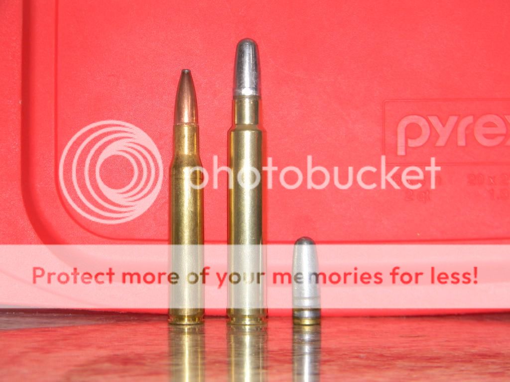

I have shot alot of cast bullets in handguns and your typical candidates for cast like 45-70, 450 Marlin and 458 WM but this is the first time with a high velocity bottle neck cartridge, my only intention was to fireform a couple hundred new 375 H&H cases, I ended up with a cheaper and lower recoil practice load, I was intimidated at first because there isn't much info available from other shooters or published load data, I acctually worked my load down istead of working up to a maximum load like normally done, I ended up 5 grains lower than what I started with, caution is advised doing this because I reduced load can be as dangerous and a over max load.
Here's a pic of a loaded round and a loose bullet, the smaller round is 30-06 for comparasion.
