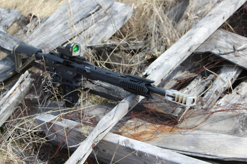

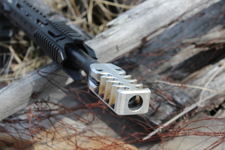

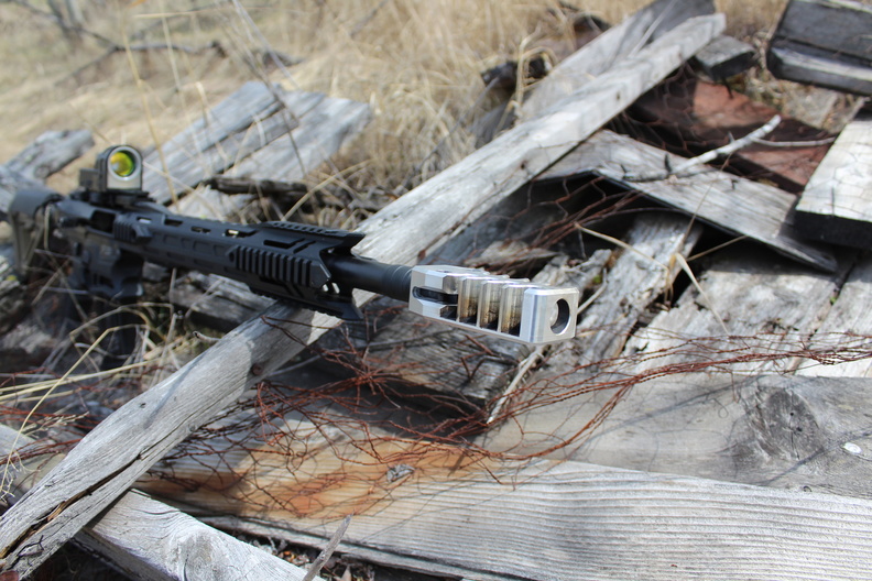

We're pleased to announce that we will be bringing a new muzzle brake to market. We just finished our prototype and are in the process of testing it.
Here's some basic specs:
  • Material: 7075 T6 Aluminium
  • Finish: Type 3 class 2 hard anodized. (Not pictured)
  • Threads: Not required - clamp on.
  • Mass: 180g
We opted for aluminium to keep the weight down. Since pressures and gas temperature at the muzzle is lower than rifle rounds, aluminium is a suitable material.
Price: $150 estimated.
Here's some video and pictures of our prototype we made today:

What's the radius where the baffles and the bottom meet? Looks pretty sharp a corner. Might be worth doing a pass with a bull nose mill instead to strengthen it.
