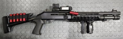

All sorts of do-dads on this 14" M4 Entry. The best upgrades for my money are the GG&G oversized Charging Handle and their Extended Bolt Release Tab. Wolverine Supplies carries GG&G. The "Hayle Rail" also isn't a bad way to add some functionality to the Handguard, along with the "Match-Saver" spare round carrier ahead of the Ejection Port..
Aside from that, it is a free-for-all when it comes to short-range reflex/holographic optics, lights, lasers and so on/so forth.

Interesting you got a shell carrier to go on the telescoping stock.
Mine came with the telescoping stock, I found the best position length for me was the spot where it takes down, I ended up replacing it with the field stock and it is way more comfortable. I do not think you will be able to co-witness your sight with the irons unless you replace the rail, Scalarworks I believe is the company that makes a rail that will allow you to cowitness with the irons. I picked up the S&J combat charging handle and it has worked well + Canadian made. I use the S&J light mount that replaces the front sling loop and it works okay except it rotational play that I do not like so I may one day replace it.
I used a stick on velcro on the side of the receiver and a shotgun card to hold my shells, its much nicer than a standard bolt on carrier as you can quickly replace the card with a full one, or store it in the safe with the card off so it takes up less room. I have been looking at the extended bolt releases, and it is a worth while upgrade for sure. I just havn't found one that I really like yet. I am mostly worried about something getting stuck behind the extended tab and not allowing it to get pressed in completely, or break off as it is only a small bolt holding it in (Some require you to drill and tap the OEM button). If it breaks off atleast you can still press the button, but maybe someone with more experience with the extended bolt releases can chime in.
