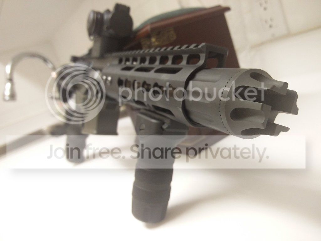

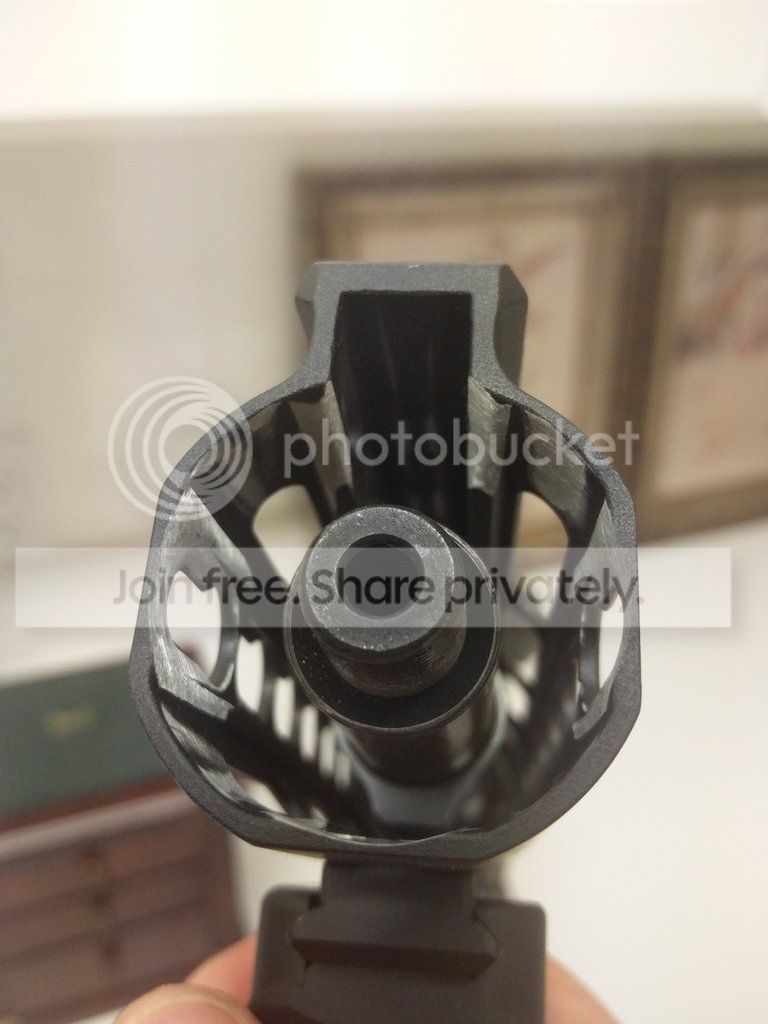

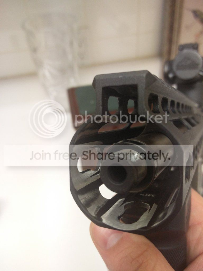

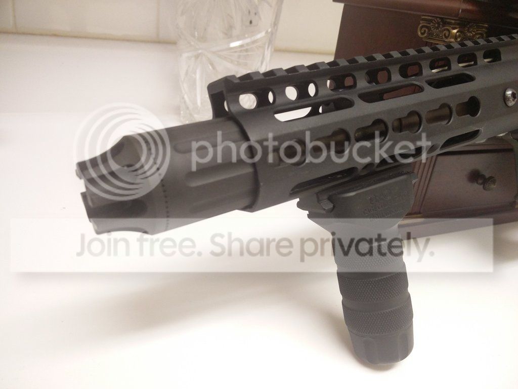

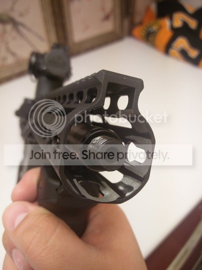

For anyone still wondering. the PWS Does NOT Fit under the Noveske Rail, however with some material removed i got it in. will post some pictures tonight.
I really feel the PWS makes the rifle feel balanced and easier to handle. It really completes the overall look of the rifle. In my opinion of corse, i know not everyone feels the same about everything.
Here are some pictures of the material needed to be removed, it was quite hard Aluminum but i took my time and it worked really really well. i will be getting everything repainted soon enough.
