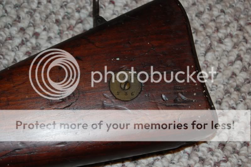

Helping a neighbour out with a firearm to determine what he has. From what I can tell, this is a Lee Enfield .303 No 3 ERA (Emergency Reserve Arm). I say that as the rifle is stamped just above the serial number with E R A. This was sporterised at some point in it's life. Can the Milsurp guru's tell me if I have this right? I based this upon info found at the following site;

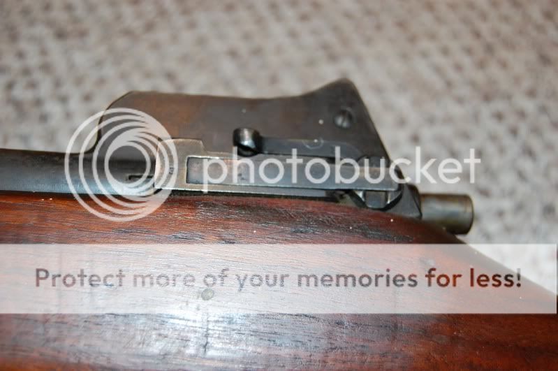

Barrel appears to have been cut/shortened so beyond restoration. However, rear Volley Sight and RAF Unit marking disk are worth a few dollars to a collector.
Royal Air Force marked! Very scarce indeed.

It is a peep sight. The front sight that went with it was a pointer on a dial on the left side of the forend. Used for very long range shooting.
