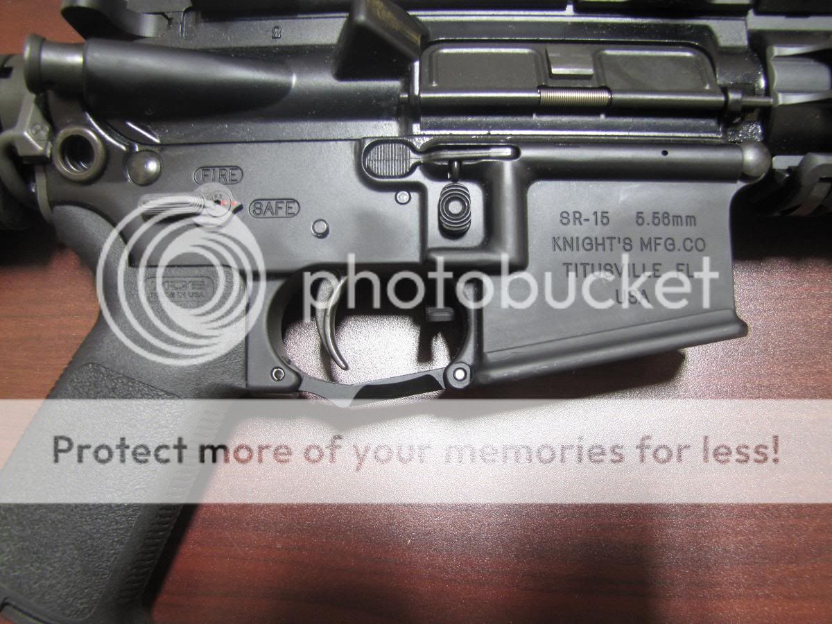

That would be appreciated, while I found videos and some "small" pictures, I was unable to find any large clear pictures of this rifle up close. Also by chance did you weigh the gun prior to adding optics etc? I ask again only as on KAC site there is no weight mention. Thank you for assistance.;)
Pictures, as requested.
