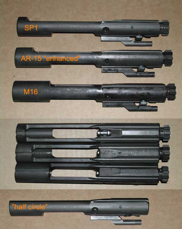

Full auto requires a full auto BCG (Bolt Carrier Group) and a full auto FCG (Fire Control Group).
If you were to use a SA BCG combined with a FA FCG, it would only function as SA.
If you were to use a FA BCG with a SA FCG, it would only function as a SA.

No true at all. The extra metal on the bottom of the bolt carrier is what trips the full auto sear. Without a full auto bolt carrier, it will NOT operate as a full auto, even if you do have a full auto lower.
My understanding was that the only difference between an FA and SA carrier was the FA carrier had extra material added to it to slow down the time it takes to cycle and therefore improve weapon control and reliability when firing in full auto.
That was my understanding and assumption as well.
The difference between an M16 and commercial bolt carrier is that the former has a ledge on the underside that is capable of tripping the auto sear. M16 carriers are actually commonplace nowadays on better quality AR-15 type rifles, as the extra mass is considered beneficial from a reliability and durability standpoint.
A select fire lower with an upper containing an AR-15 bolt carrier will not produce automatic fire, as there is nothing to trip the auto sear. A lower without auto sear and select fire FCG parts may or may not function in automatic fire, as the hammer will follow the bolt carrier forward and may or may not strike the firing pin with enough force to ignite the primer.

Many of the retail stores will put on their website saying that FA carrier will not allow you fire your AR15 in full auto.
