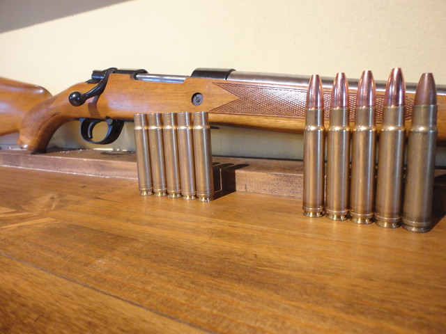

Im wondering about color case hardening high pressure rifle barrels.
Ive been doing some work machining for Oskar (https://ww w.oldguns.ca/restoration-services.html)
And for this next job i was thinking of getting some parts CCH. I have 2 remington no6 falling blocks to get done. Then i started thinking it would be cool if i got my 460 weatherby barrel CCH.
Im not sure where the barrel is 4140 if its a good idea or cant be done.
So my question is can you CCH high pressure barrels with out any ill effect?
Here is the rifle id like to do it to

The only barrels I have seen case hardened, have been pistol barrels (See Turnbull Restorations site) I know that it is possible to pull up pretty good case colors at lower than through-hardening temperatures, but I would be pretty leery of cooking a barrel and quenching it, with any expectations of accuracy afterwards.
Consider, that almost all the heat treatment of barrels is related to stabilizing them or releasing stresses, while quenching a color case part is pretty much the complete opposite of that, you quench the part in a bucket of water and assorted chemicals, with a bunch of air roiling the whole thing up like it's at a boil.
I'd definitely ask the source. Worst case is a crooked good looking barrel. Well I suppose, worst case would be a blown up barrel...but...
I wouldn’t based on the metallurgy of it.
First concern would be the wrong heat treat for the pressure.
Second concern would be distortion.
In my experience, absolutely not. This is not to say it might not be possible to colour it by some means but colour case hardening just doesn't work on 4140. I have seen case hardened 4140 actions which cracked while sitting on the workbench.

Ok thanks, thats why i made this thread. Ill just get him to blue it for me then.
I just thought the colours would look good on the barrel and it needs to be protected anyway.
I thought that maybe one could temper the barrel after to what ever hardness you wanted (~35 rc)But also realize it full of carbon so not sure how if it would work like mild steel.
If it was low pressure i wouldnt have been so worried.
Pre-war mauser receivers were case hardened mild steel, But where the barrel is 4140 it kinda throws a wrench in the mix
blued it is.
