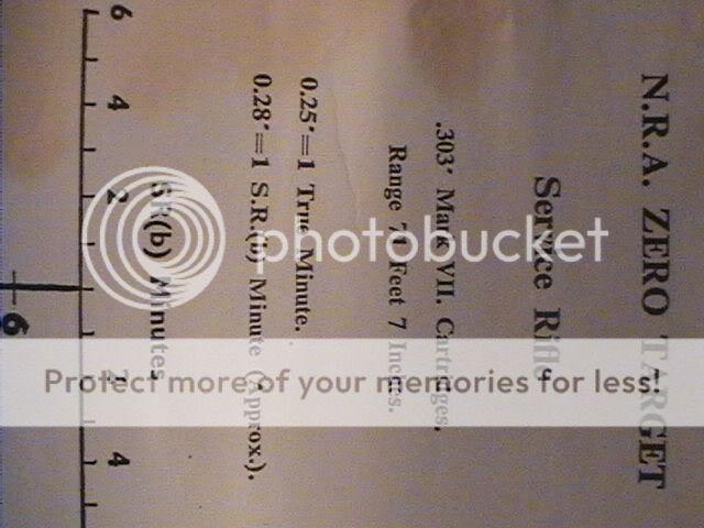

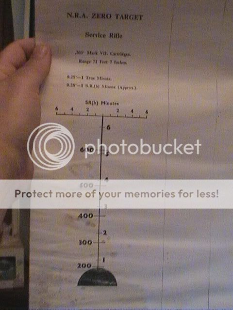

For those good at maths 71 feet and 7 inches but 25 to 30 seems to do. I only have paper photocopies but you are welcome to one of these or I can get a card one from Bisley in the post. I also have high and standard velocity .22 rf table targets for the same job!
Sorry I couldnt get them the right way up, I'll get new cards as these have been in my folder in a damp garage for a few years. If they no longer make them then I'll get these scanned on out A3 scanner at work and you can print on card!
It does look like you start at 200 yards and adjustments can be worked out for Vernier scale sights at the magical 71 feet and 7 inches!
I can e mail these but a card if you want is no problem next month, pm me your address!
It is necessary to exchange front sights, until the group forms at the correct point on the target when the sight is set for that range. Windage is adjusted at the same time.
