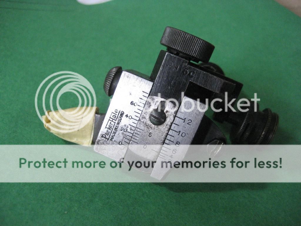

The ejector screw hole is often used as the screw mount hole for a Parker Hale type target sight. The sight hole is under the masking tape.

OP, if you're looking to put a scope on there is a mount made by a CNC outfit in ON that is sold on eBay, . It attaches via the backsight axis pin hole and the ejector screw hole. You need a longer than normal ejector screw to do that obviously and those are available. The sight in Ganderite's photo above attaches the same way. Your other option is the S&K type mount which replaces the back sight and clamps onto the top of the charger bridge.
