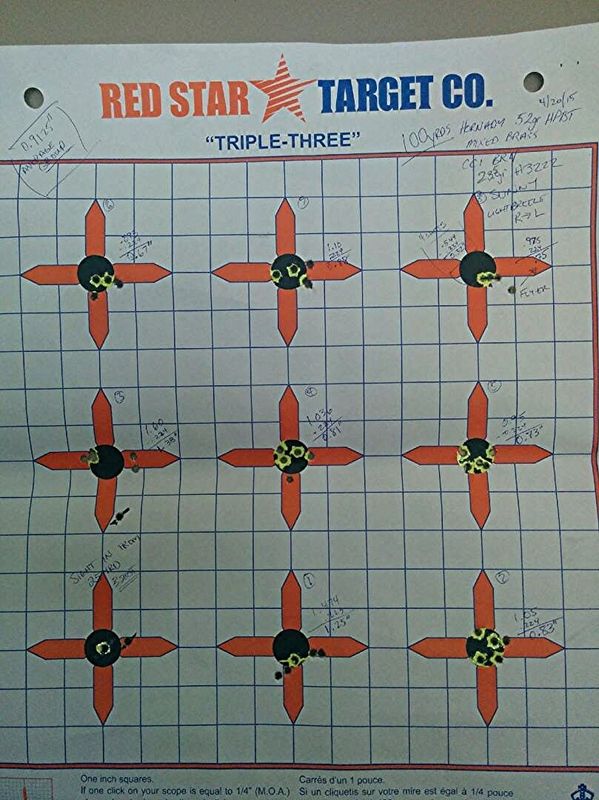

finally got to hit the range with my new rig yesterday Savage 12 with 18" heavy bbl vortex viper hst 6-24x50. nothing better than having the range to yourself all day long @17 degrees and sunny with varied wind going left to right
I bore sighted at 25yd, fired three to get close then moved to 100yd 3 shots on the bottom left target and was very happy with the results.
I set the crs zero stop after the second group and had to use all the shims but one. Is this normal? I have not counted how many revolutions I have before it tops out but it tracked perfectly. I'm running what I was led to believe is a weaver 20moa rail and burris signature zee rings. Shooting hand loads I developed for my 20" colt hbar. hornady 52gr bthp, cci br4, mixed fl resized brass, 23.5gr h322
I won't be shooting more than 250yd at the range but would like to have the option of shooting further on forestry lands here. Am I missing something here? I'm new to this type of shooting so thanks for your patience.

As a side note try eliminating the big black dots on your targets. They're good for iron sights but the triple 3's crosses are much better. Also, check to see how close to mechanical zero you are on your elevation. That should give you an idea of whether or not you have a canted base.
