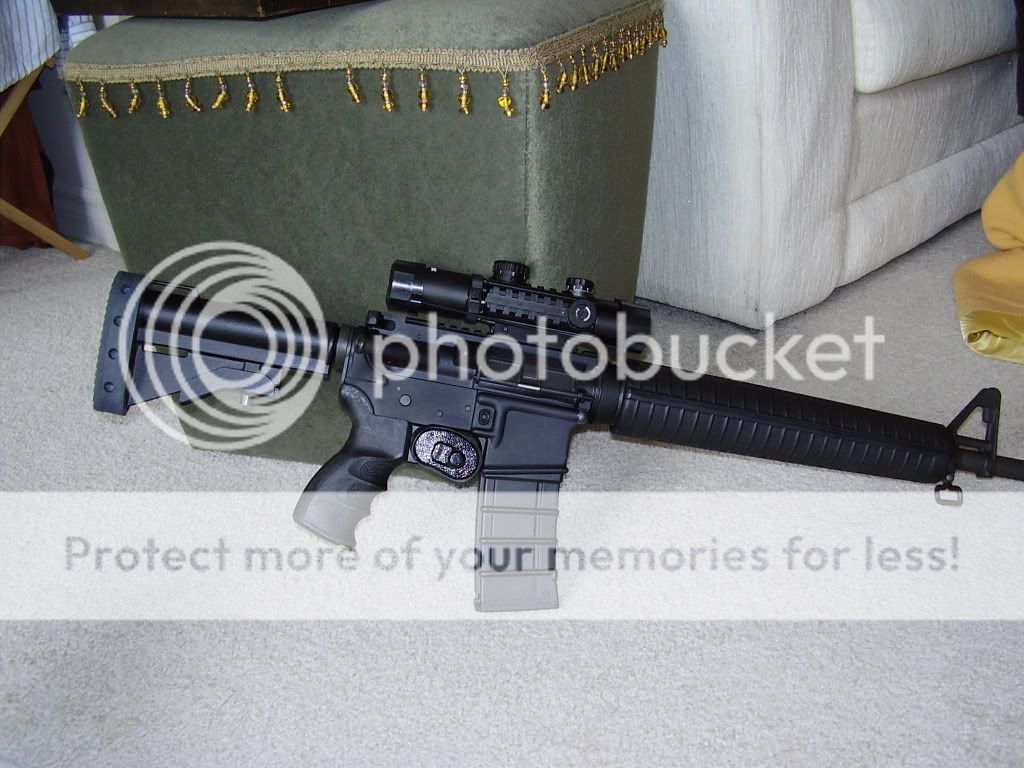

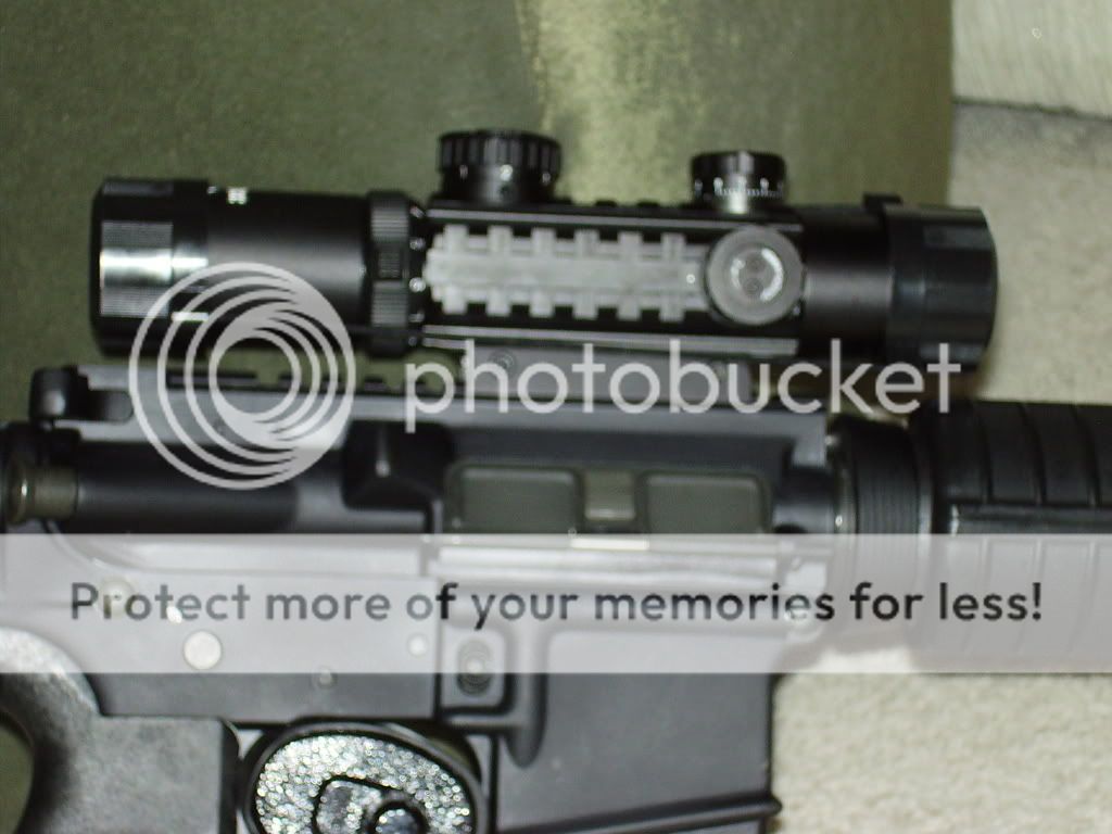

take a look at the two pics here. when I look through my scope, I can see the front sight through it. thus when you zoom in it really obscures your view.
gun is a Colt flat top 20"
what have I done wrong here?

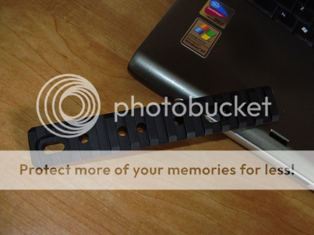

while Im at it, I would like to add a handguard rail handle. my question is do I have to first replace the whole handguard or can I attach the piece (pic included) to the handguard and then just add the grip to it?
will this piece connect to a standard Colt handrail? if yes, how do I attach it? (a guy gave me this piece, but no screws or anything with it)

Second, you didn't do anything wrong, I too have a fixed front post that I see in my scope (TA31F). As the TA31F is a 4x, I hardly notice the post. Don't worry about it.
Third, don't know if you can attach the rail directly on the handguards you have. An option would be to get a free float railed handguard. (what I did on my 2 ARs..)
Your scope is sitting quite low for an AR, do you find it comfortable to look through? The front post shouldn't be an issue, when you focus on your target the post should virtually dissapear.
As for the rail, try lining up the two slots with the holes in the handguards, should fit without any issues. The screws you'll obviously have to supply yourself. I'd recommend T-nuts for inside the handguard, but a regular nut will do. You may have to put holes in your heat shield depending on where you want to mount your rail.
