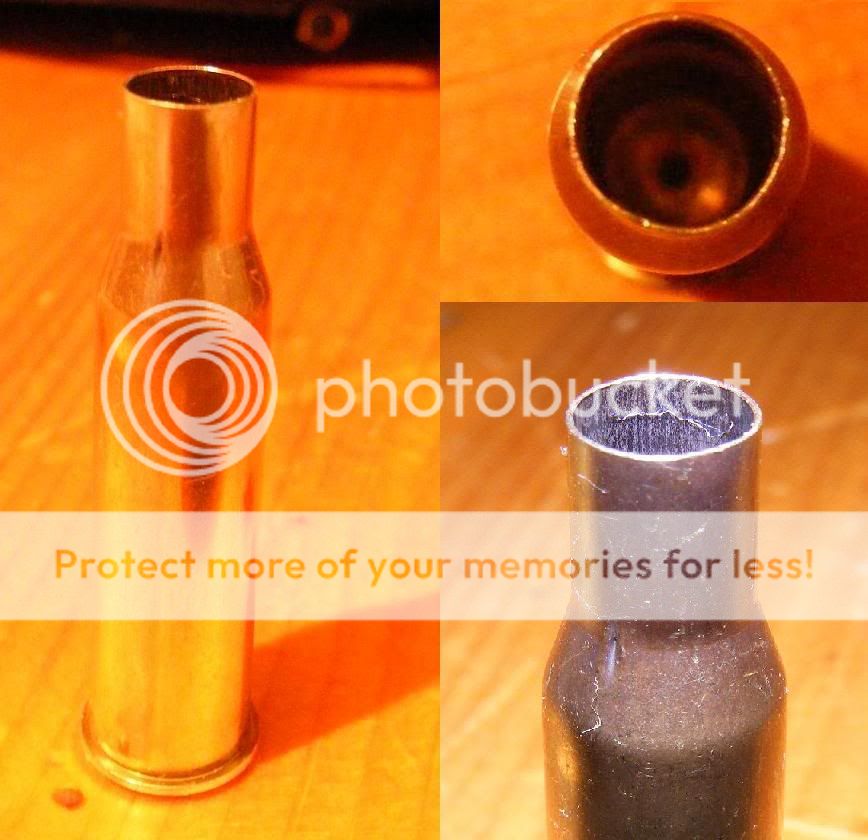

Last evening I carefully inspect all brass from the box & in discover that many necks are out of round as some of you said!
I test charber about 10 cases & all of them load like a charm.
Altough one case had a serious flaw that make me reject it:
It is like a light bulge made during forming.
My conclusion: a serious & careful inspection is mandatory

Looks like the bulk remington brass I've bought. They're always rough. Dings and knicks in the cases so I figure I better resize everything before I start.
