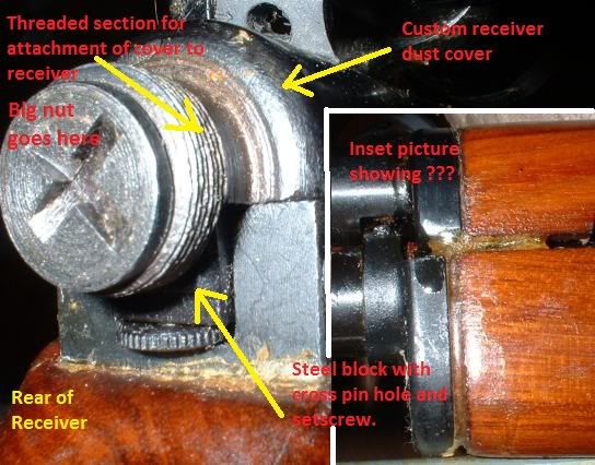

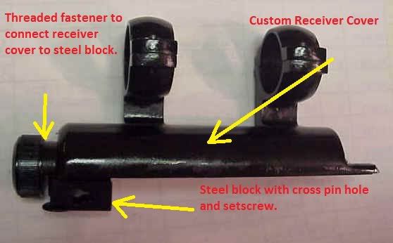

As I mention in my post there, I am at a loss trying to figure out what piece of hardware is shown in the upper of the two pictures, and how it fits/attaches/relates to the modified SKS dust cover sight mount shown in the lower picture.

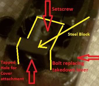

A steel block is supplied with a hole through it for the takedown lever. A set screw fixes the block in place. You now have a a no-gunsmithing tapped receiver to screw the custom top cover to.
OK. So if I have this straight, we have:
Into/Onto that goes this (which shows both the cover and the steel block, plus the attachment screw, on which appears to be a large knurled ring that could be turned by hand):
Which in turn attaches to this:
Is that more or less what the various pieces are, and how they fit together?
I cannot tell if the hole in figure #1 that I've labeled "tapped hole for cover attachment" is in fact tapped, or if it is a plain hole to accept a pin.

P.S. Juster, thank you! Reading the post below, the light bulb just came on. The large bolt with the "X" milled into the face is not part of the round piece with threads on the outside, that I've labeled - incorrectly - "Threaded section for attachment of cover to receiver". The round piece threaded on the outside is the back end of the modified dust cover, and has a hole in it for the X-head bolt. The screw-on ring is there to thread on and cover up the gap and keep dust, water, oil, crud etc. out of the receiver. Sweet.
"Tapped hole for cover attachment" accepts the big screw with the X milled in it, as you tighten that the receiver cover moves forward until it is jammed solid.
You don't use the takedown latch, it no longer moves. There is a screw-on cover over the Big Screw as a luxury.
I bought it from sksman, I don't know if they still make them.
The rings aren't perfect, I needed to loctite the screws in. You could cut the rings off and screw on a rail I suppose.
It works very well otherwise, a clever design.

The L-shaped bit on the left is held in place by the takedown pin, an adjustment screw makes it a solid extension of the receiver. The screw with the big cross head screws into the L-shaped bit, securing the replacement receiver cover.
