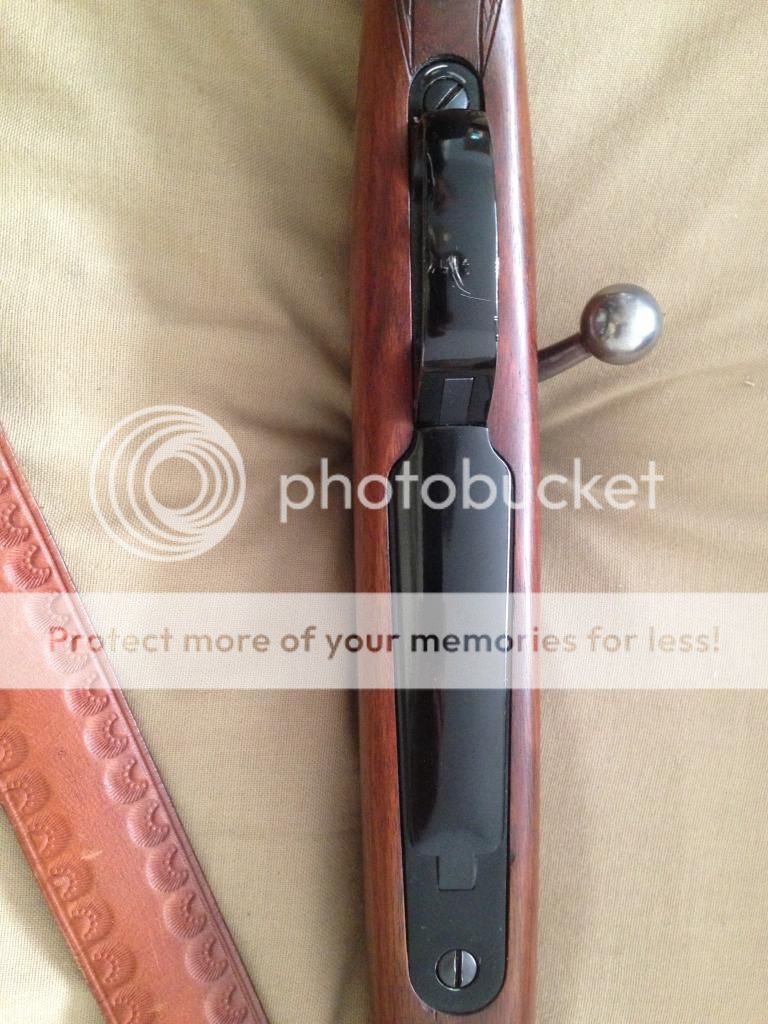

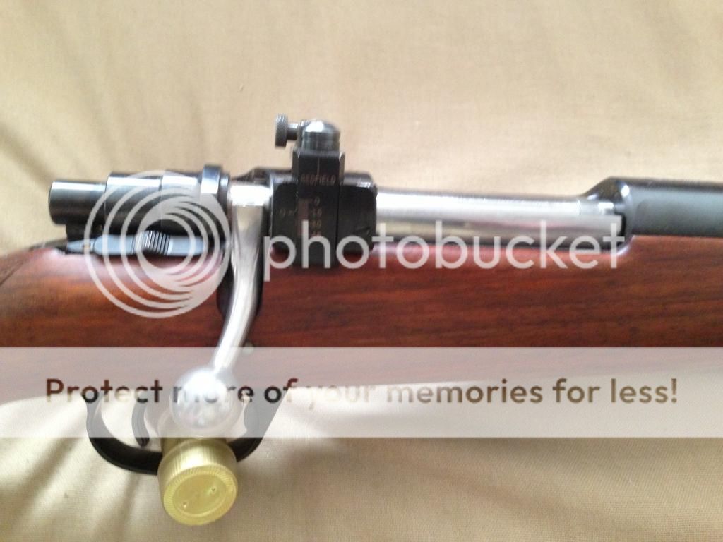

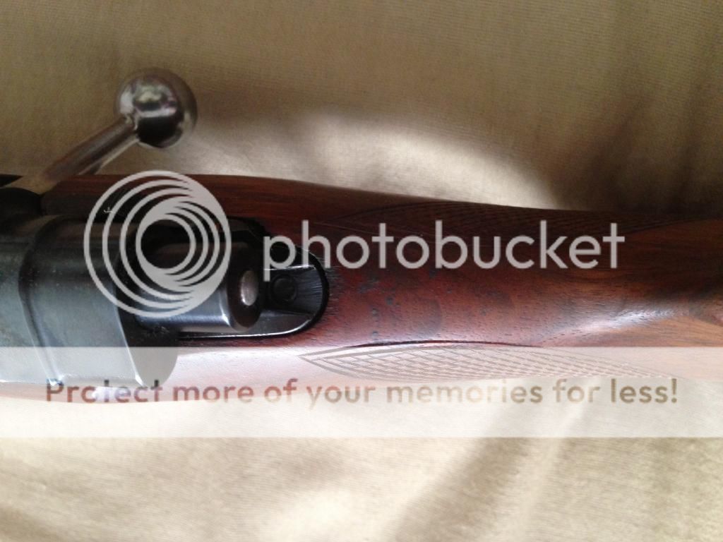

Hello all I am trying to track down some info on my Husqvarna Mannlicher stock .308 It is a model 458 and the ser# is 2648XX. My first question is does anyone have an idea when it would have been manufactured. Secondly I am having a hard time figuring out which Leupold quick detachable base to get. When I called Leupold they had nothing attached to a model 458 only bases for 1600. will the bases work from a 1600. When i went to Epps they seem to thing the Bases from a Mauser would work. Any info would greatly be appreciated . It also has a red field peep sight on it does anyone know what number it is.

Did some quick googles, appears some were man for S&W in mid sixties before they went with Howa. Apparently based on model 1640. Is there a S&W stamp on it? I can read Swedish and Norwegian and will assist when I have more time on my hands. Any numbers and markings you can supply will help (pics).
