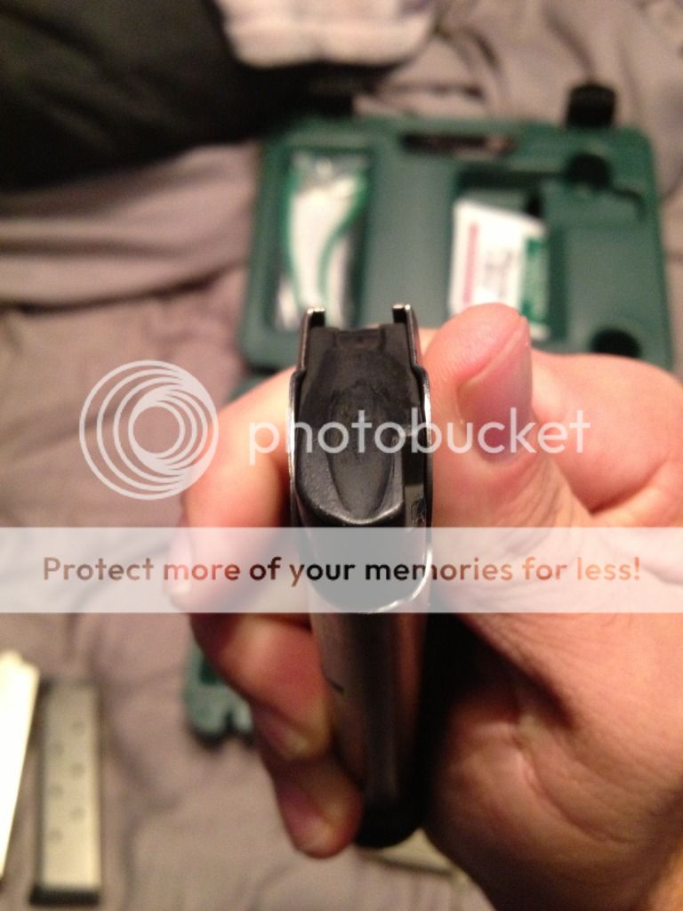

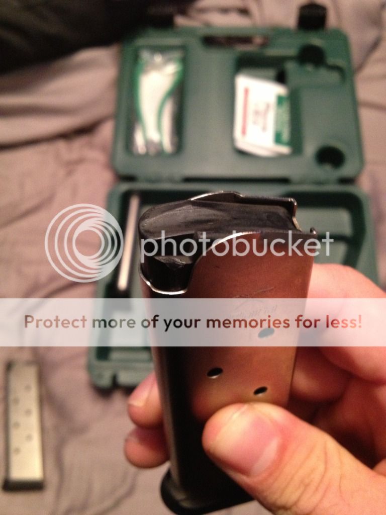

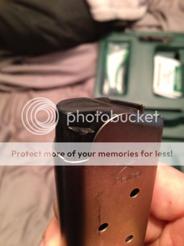

I took it to a friend at a gun shop the next day and he had a look. He was aware of the problem and suggested a new slide lock lever would probably fix my problem. He also had a look at the magazines and found that the part of the slide lock lever that connects with the magazine when it is empty was actually "chewing" away a part of the plastic follower! (Stupid me didn't even notice this the previous night!)
These are 3 different magazines, the last picture you can see particularly well what piece was being chipped off.

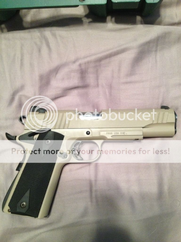

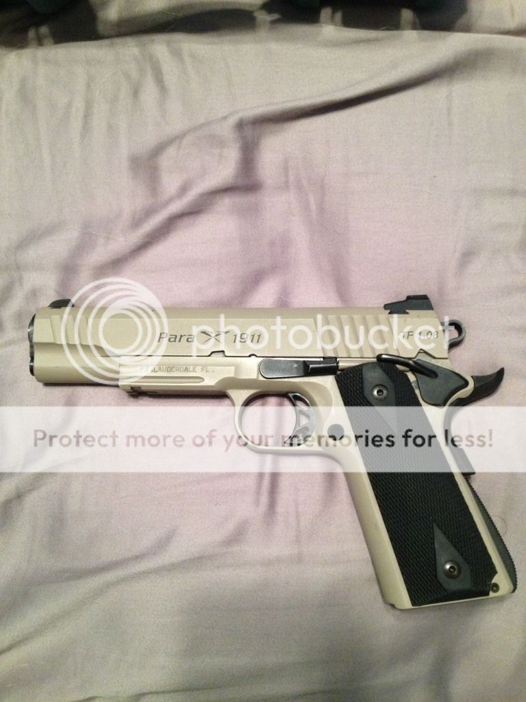

The One on the EE is the same as mine, just double stack...don't think he's going to sell it for 1500 though...

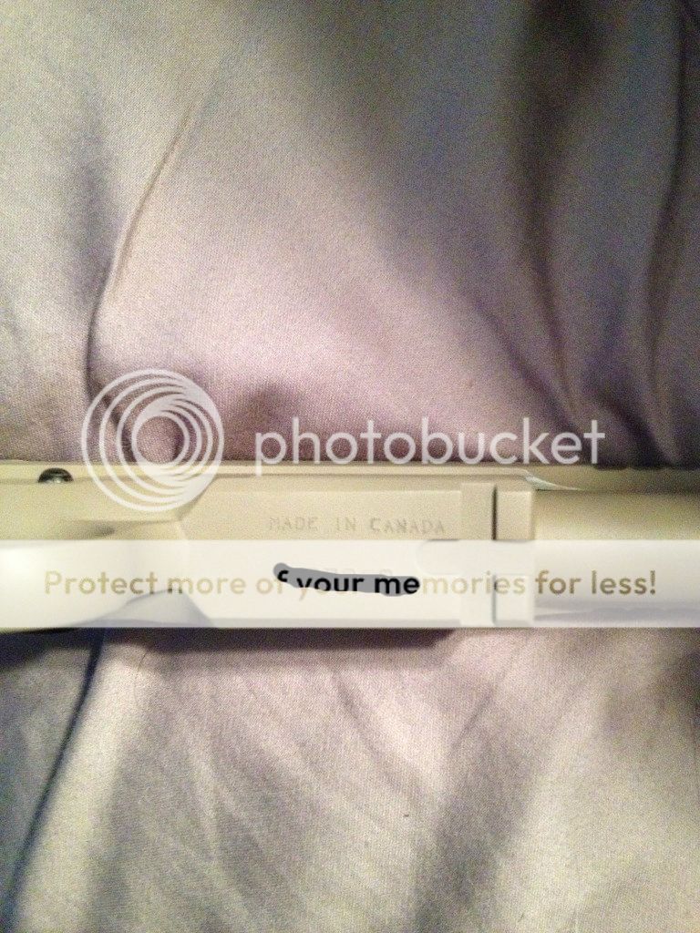

Another thing I was curious about. On the side of the frame just above the rail, it says ft. Lauderdale FL (second picture) but underneath on the frame behind the weaver mount, it says made in Canada (not pictured)...thoughts?
Interesing, ill have to checkmine. Is urs the 40 or 45?
So just got my Wilson Combat extended slide stop and it actually works with the chipped followers on the magazines! Just have to go out and test it now, hopefully there are no issues. The chip McCormick magazine follower didn't fit into the para mags so that was a dead end (cheap one thankfully!).
