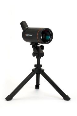

My rimfire scopes are low magnification and wouldn't work as spotters. I get it about cheaping out on optics, but can't see dropping $500+ for the very limited use I'll put this to (a few times a year). One lower-price possibility is this Celestron C70 Mini Mak model. Does anyone here have experience with it?

I looked at the Am... page and reviews were mixed, many 'looking at the moon' but a few range shooters seemed to like it. I use a 'full-size' low-cost tripod (wiggly on windy days ) but as I said I can see .223 holes easily at 180. So
low-cost' can work sometimes.
http s://www.amazon.ca/Celestron-Cavalry-25-75x-Waterproof-Spotting/dp/B071KWHWW9
I have a $40 spotting scope from Canadian Tire. It will see holes at 100, even 200 on a good day. 300 though? Not a chance.

I got a 100$ 125x spotting scope off the EE. We use it to spot 250y shots on steel, and we can see the splatter points. Obviously, it isn't crystal clear glass but what did you honestly expect? It's just fun and beats any other real option out there.

Trust me when I say cheap spotters are a PITA... for $200, you can buy ALOT of rimfire ammo to resight your high mag scopes after you are finished testing on your centerfires. Why the concern to mount the high mag scopes on the centerfire rifles? All that you have listed will work just fine on any of your centerfires.
For most shooters, they will be miles ahead putting their spotter budget into their operational scope. Good spotters get interesting around $800... you really want to see stuff at 300yds, bring MONEY. By contrast, you can get GREAT scopes for similar money.. and have far more utility.

Don't buy spotting scope for the purpose of looking at bullet holes out to 300 yards and beyond.
