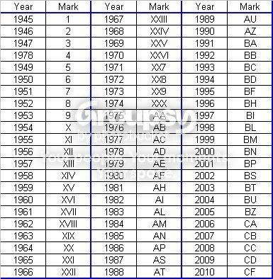

I have never heard of Ultra-Hi (Brand Name???)..but here are the date codes for Italian Reproductions so you can date it. It should be stamped on the right hand lower frame.
Ultra-Hi is a brand from the 70-80's i have found so far, very high quality, everthing is still very tight and no looseness. They imported it from Italy..so i will look for the marking, thank you.

So its has an AC stamped on the frame so its a 1977, sound about right, i wonder if i order a pietta extra 44 cylnder if it will work? hmmm
