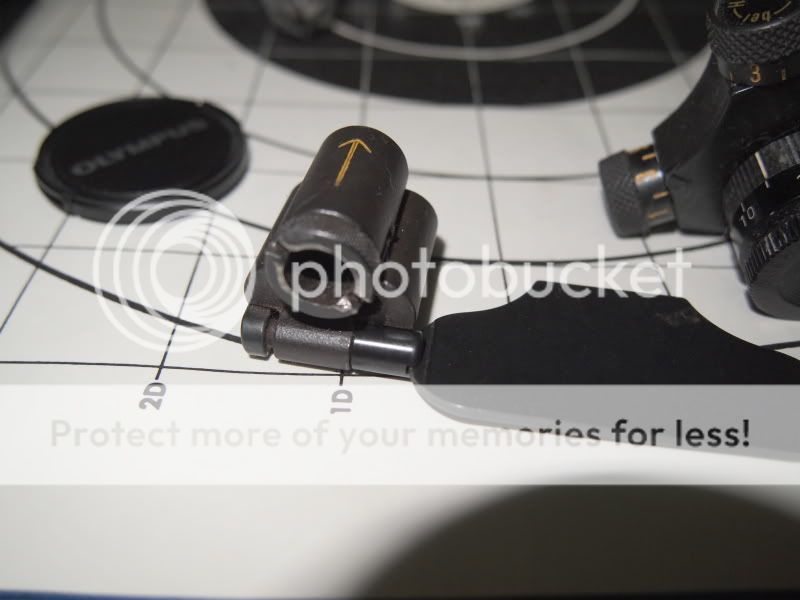

Can you tell me more or add a pic of those 562 Iris... I'm curious :eek:
Is there any different *reticles* for the front sights ??? I think you change them...???

The W&F front sight for the K31 use Lyman 17A size front size inserts.
http://www.lymanproducts.com/lyman/sights/target-front-sights.php

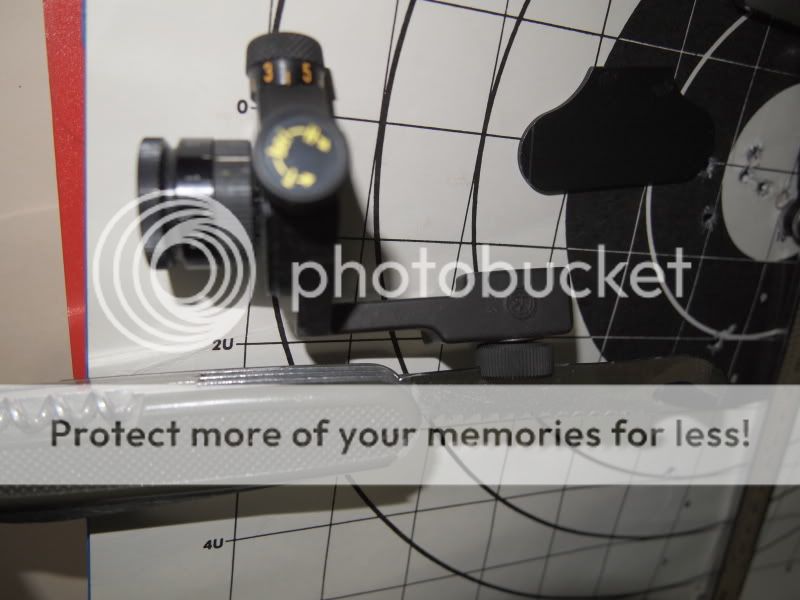

From what I can see the Diopter sights are good ones...And I think I had them at a fair price :rolleyes:

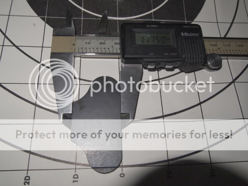

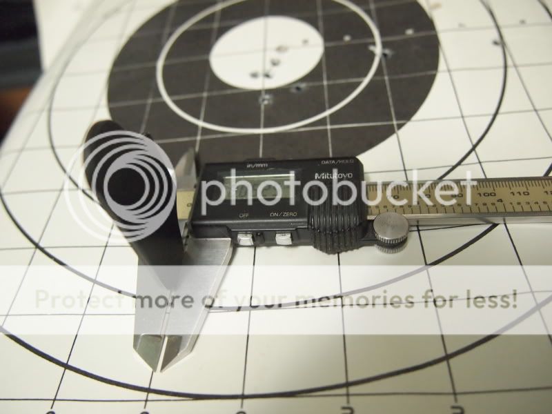

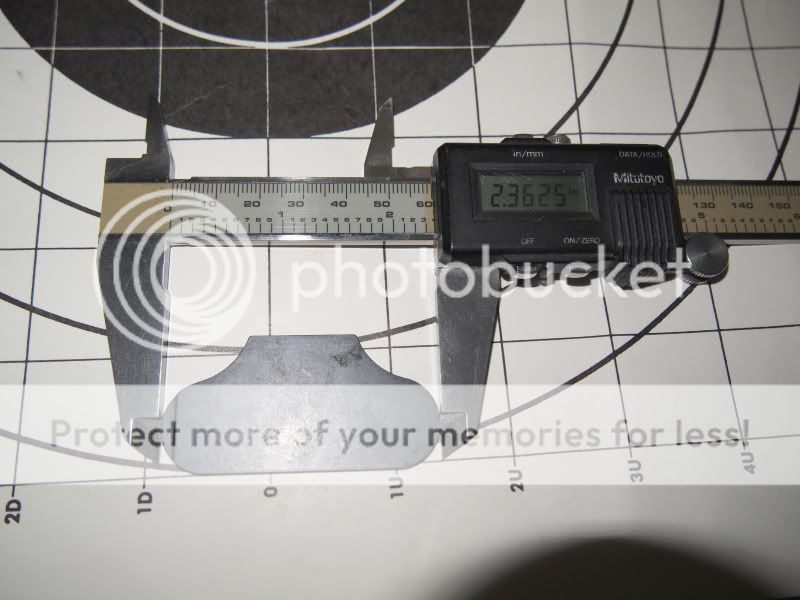

The only downside is I don't have the tool to tighten the sights properly.
Can you show me one with a graduated rule so I can duplicate it...
Oh and don't forget the thickness...
I already saw one on a picture but I dunno the dimensions.
Thx 4 all Diopter !!!
