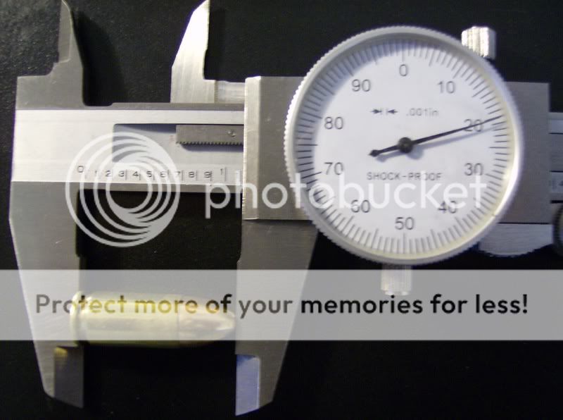

Shot of the caliper:
The Combat Master's stuff is at 1.120...
....and mine at 1.152.

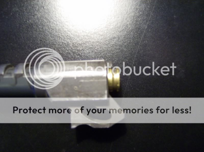

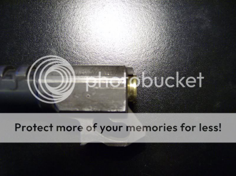

Last but not least, here is how it fits in the chamber. You will be able to see the obvious difference with mine not going all the way in.
Combat Masters
Mine
I guess the CZ barrel wasn't made to take max. length cartridges.

You have to have a shorter length due to the profile of the bullet. If you were to pretend the bullet on the right had the additional pointy part then it would be way to long.
Your bullet on the right has a lot more of the body of the bullet sticking out of the case. It is hiting the rifling and getting stuck without being able to close the action and without the case being able to be chambered.
Even if you could get this to fit in the barrel I would be surprised if it would feed properly in the gun.
Thanks, this is what I was wondering. It was the only thing left in my "process of elimination", that could have answered for why it wasn't feeding.
