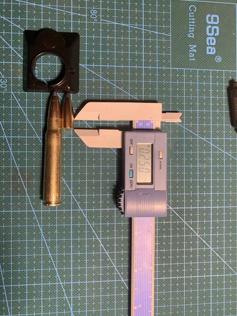

update: 2.24x works fine in both my mausers. My bullet is 150gr Speer hot cor. So if I seat a full caliber length it seems to be a bit too much. I ended up with 0.25 into the neck. Tried on both rifle. Chambers fine and magazine also took it

You should be more like .313 into the case for proper neck tension. I wouldnt be surprized if those work just fine. But if it was me id seat them .065 deeper.
Edit, well after a second look those bullets do lood pretty short though. A full caliber deep may be already into the taper or just close to it
Yup. Pretty short indeed. Now it look like this
I am thinking of backing out a bit
I wouldnt worry about the look of them as much as the function of them. If they feed and function well in the rifle, personally id leave them that short.
It doesnt look like the case is over hanging the taper at all.
Im sure either will be fine.
thanks I will keep them short then!
