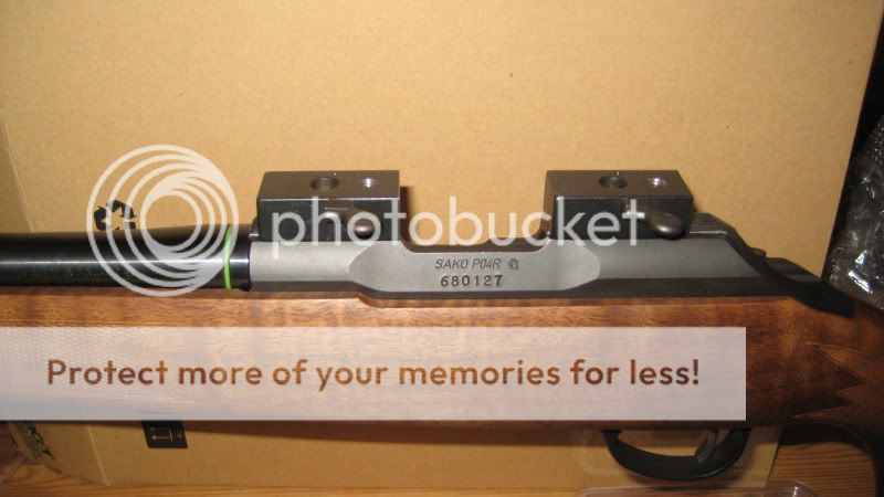

The quick release Sako brand optilock bases seem hard to comeby, at least in canada !? Does anyone carry them?

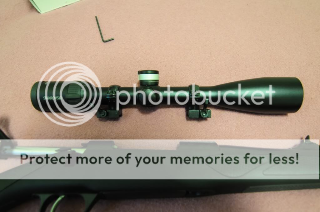

I've found that leupold also seems to makes a Sako 85 quick release mount, however in their case, only the rings remove and not the complete mounts. Would this obstruct my vision through the iron sights? I imagine it would, which defeats the purpose for me...!?

This would be my fist choice, without any doubt: h ttp://www.masina-tuote.com/en/varusteet.html
Scroll down to SAKO mount; the mount uses SAKO's own dovetails. It's no "web shop," but they ship...
FWIW, I have no personal experience with this model for SAKO, but I have their QD mounts for Tikka M55 and M07 - both are superb products, no issues with POI between removals and re-installs.

For what its worth, the main reason I dumped my Optilocks in favor of MaSi mount was the instant ability to access the irons, without loss of POI upon remount However, as it turns out these are - IMHO - better engineered mounts, and the components are better quality than most others that I've used. As one example, take a look at the ring screws:
Anyone who have struggled with stripped Optilock screws know what I mean. Also, these mounts have other features that make them great for bolt-action rifles, and the design eliminates the need to "lap" your rings.

I'm starting to second guess my assumption that the Leupold QR bases don't allow for the use of Sako's iron sights... Does anyone have experience with this ? They may not be as tall as in the first picture I posted after all ...!?
