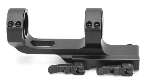

Last part I need is the mount. What would be a good quick release mount? A solid mount that returns to 0 after remounting and won't cost a fortune.
Looking for something like this. The catch is that it needs to have the front arm high enough to provide clearance for ejecting spent brass otherwise it bounces back into the action and causes a jam. Thanks.
But the point being IF you install the shell deflector then the quick detach mounts clearance wont be an issue. I cant offer any suggestions on AR optic mounts because Ive never owned an AR with a optic on it....:confused:

I have a strong suspicion that on a vz58, the arm of the mount will do a decent job of protecting the scope from ejecting brass. You can get an idea of how much overhang it has from the pic below.

Nice AR! I think you're right the mount will deflect the spent brass just fine. If not I'll make a deflector.
Ordered a Burris PEPR mount hopefully it'll do the trick.
This is what I used on my vz with the railed dust cover. Made shell deflector from an sks one. The QD rail is the NEA one.

That's what I had in mind for a QD mount with a deflector. Did it give you any problems with brass bouncing back into the action?

No issues at all worked perfectly. Yes it's the zhukov handguard
