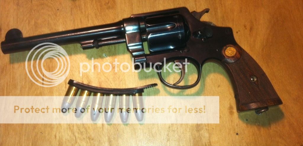

I'm pondering throwing my hat in a novice class (vintage revolver) at a local IPSC match.
There are no speed loaders for my New Service. I can run a semiautomatic with a pocket full in clips, but I shoot my New Service far better.
What is the most effective way to reload with loose rounds? Dominant hand for loose rds ? Lots of speedloader videos online; which are of little use when dealing with loose rds.
Thanks

Make up a wooden loading block from which you can grab at least two or three rounds at a time with your thumb and first two fingers. It is amazing how fast you can reload 6 rounds using this method once you master the technique. Otherwise, store your `loose rounds`in the same orientation (bases up, for example) in whatever container you choose, so you can grab them in bunches of two or three for reloading. Hope this is some help in finding a solution.

The strips are great for storage/carrying, but they are not fast when reloading. Probably quicker with loose rounds providing that you are holding them right. Just dont expect lightning fast reloads. They are a good alternative to loose rounds in any case. I actually prefer the old dump pouches which work well until you accidentally snap open the bottom flap and out go the rounds..Probably why they are named dump pouches..:)

I use speed Quick Strips with my S&W .455, get the .44/45 strips (you load 2 at a time ... and its way quicker then loose rounds!). When I first joined the cops, we used loose rounds in a double dump box (6 in each), then we went to speed strips, then speed loaders, then transitioned to Glock 22's ...).

Da Bear; I concur. My daughter timed me with a strip ( Snappy Hooker with holes punched for cartridges...tarp strap, lol) vs loose rounds; pretty much exactly the same time, 10-15 seconds.

If speed is important to you I think with some practice the speed strips will be quicker and have the advantage of keeping all the cartridges together and oriented in a consistent fashion.
I'm guessing you are more practiced with traditional methods vs speed strips (not homemade) so if the times were similar it stands to reason there is more room for improvement with the strips.
Otherwise cartridge loops spaced apart in pairs so you can try and grab 2 at a time might be an option.
