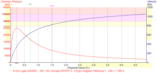

Cartridge : 9 mm Luger (SAAMI)
Bullet : .355, 124, Hornady HP/XTP 35571
Useable Case Capaci: 9.751 grain H2O = 0.633 cm³
Cartridge O.A.L. L6: 1.169 inch = 29.69 mm
Barrel Length : 5.5 inch = 139.7 mm
Powder : Hodgdon TiteGroup ?
Predicted data by increasing and decreasing the given charge, incremented in steps of 1.0% of nominal charge.
CAUTION: Figures exceed maximum and minimum recommended loads !
StepFill.ChargeVel.EnergyPmaxPmuzProp.BurntB_Time
%%Grainsfpsft.lbspsipsi%ms
-10.0493.60996273211742171100.0
0.668​
-09.0503.641003277216162191100.0
0.663​
-08.0503.681010281220652210100.0
0.657​
-07.0513.721017285225182229100.0
0.652​
-06.0513.761023288229782248100.0
0.646​
-05.0523.801030292234422268100.0
0.64​
-04.0523.841037296239132287100.0
0.634​
-03.0533.881044300243892306100.0
0.629​
-02.0543.921051304248712325100.0
0.623​
-01.0543.961057308253592344100.0
0.618​
+00.0554.001064312258532363100.0
0.612​
+01.0554.041071316263522382100.0
0.607​
+02.0564.081077319268582401100.0
0.602​
+03.0564.121084323273692420100.0
0.597​
+04.0574.161090327278872439100.0
0.592​
+05.0574.201097331284102458100.0
0.587​
Results caused by ± 10% powder lot-to-lot burning rate variation using nominal charge
Data for burning rate increased by 10% relative to nominal value:
+Ba 55 4.00 1080 321 29126 2315 100.0 0.587
Data for burning rate decreased by 10% relative to nominal value:
-Ba 55 4.00 1041 298 22457 2434 100.0 0.646
