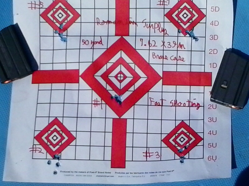

here a target from 50yard on my xcr-l with romanian surplus ammo in brass case fast shooting ,
What's your idea of fast?
That's some nice shooting for fast pace and letting the barrel get hot. I'd like to see it hold those 2-3 moa groups at 100yds :p
